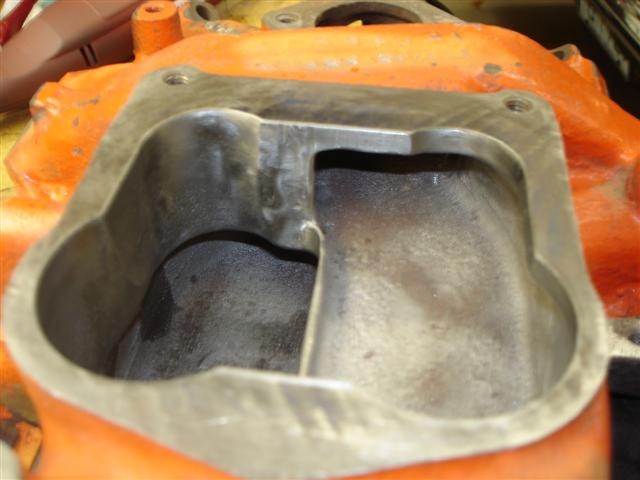

The strip dominator and the M-1 are almost identical, including that stupid spread bore carb pad and goofy 90* angle from the carb out to the runners. I run a strip dominator that is heavily worked over to correct that issue.
Yep in stock form they are week, i put a lot of work into mine also, they also have core shift and the runners needed a bunch of work to "line up"

Is that your handiwork?
