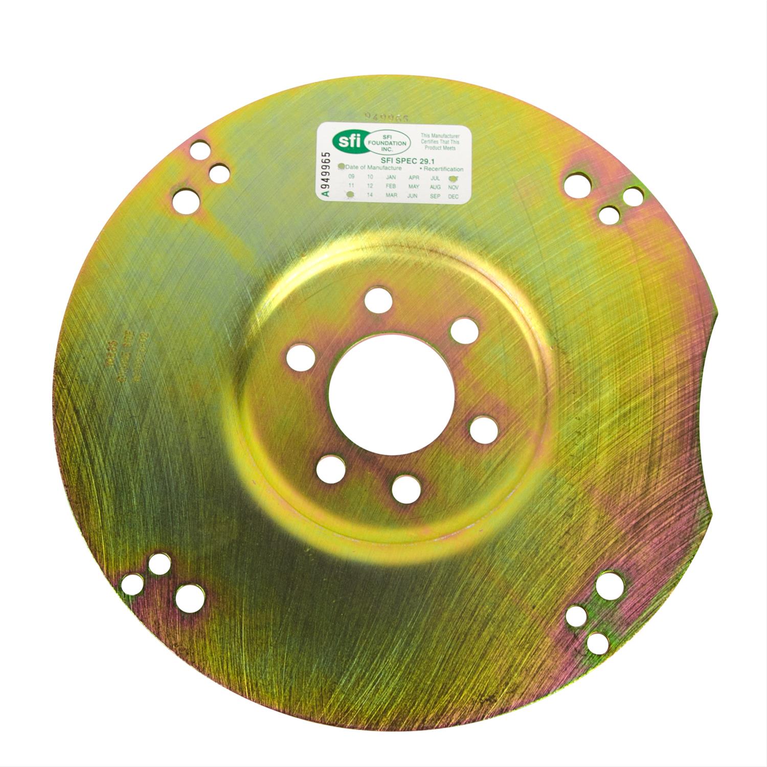

So….picked up a 340 short block to replace my 273. It came with a cast crank, I have a line on a forged one. My understanding is 340’s with forged units are internally balanced and take a different balancer than the cast units. Question is do I still need to change the torque converter or use one of the B&M flex plates?

Cast crank 340’s are externally balanced on the front and rear.
Steel crank 340’s are internal, so you would use a neutral damper & flexplate/converter with one of those.
Yes, cast 340s used a different torque convertor/flywheel in addition to the balancer. DON'T mix and match.

The cast crank will be just fine. I have had a few cast crank 340's that I beat the living snot out of back in the day. Not a one of them ever gave trouble. You need the 10235 B&M flex plate. Also, since you are replacing a 273, check the size of the register in the tail end of both cranks to see if the one on the 340 is bigger. It may or may not be, depending on the year of the 273. If the register in the 340 crank is bigger, you will also need an adapter ring to put into the crank register in order to use your existing torque converter. Somebody on here makes and sell the adapter ring, or any machine shop worth its salt could make you one.

If you use the 340 only cast crank, yes, you will need the correct balancer and flex plate or converter to go with it. If you're getting a stock forged 340 crank, your 273 balancer, flex plate, and converter will work fine. As mentioned, if your 904 trans is '67 or earlier, you'll need the reducer bushing for the crank to match the button on the converter. You can also use your 273 crank in the 340 without any other major changes. Just get everything balanced during your engine rebuild.
I'm unsure I agree. The 340 crank is neutral balanced, but it gets there differently than a 273. The 340 crank had gundrilled first and I think last crank throws, so the 273 stuff, although neutral balanced, gets there differently. It'll be best if he balances "whatever" he decides to use.
