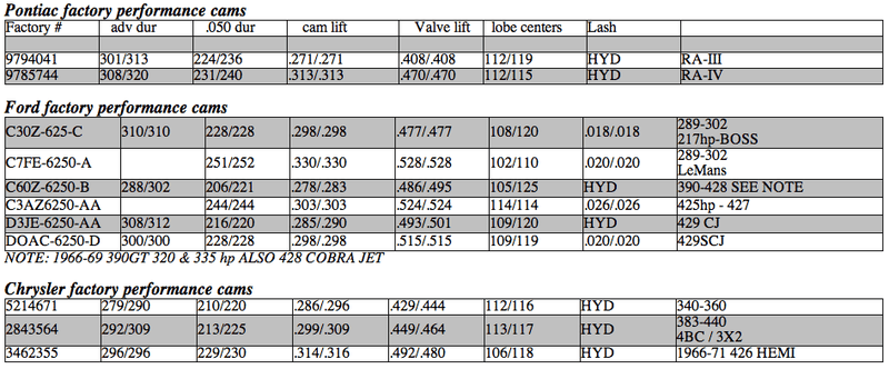

340 68 auto and 360HP cam
279/289 @.004 429/444 114LCA
268/276 @.008

65, the two Pontiac cam specs they provided are reversed. The 041 is the larger of the two. :):)
