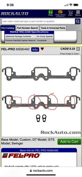

Take the 273 heat shield and trim the ports off leaving the vertical shield portion next to the ports then rivet the heat shield at just above the port bolt holes to a Felpro 340 exhaust manifold gasket.
I did this on my 340 and you can’t tell the difference from a reproduction.
It’s been on my engine that way for over 20 years

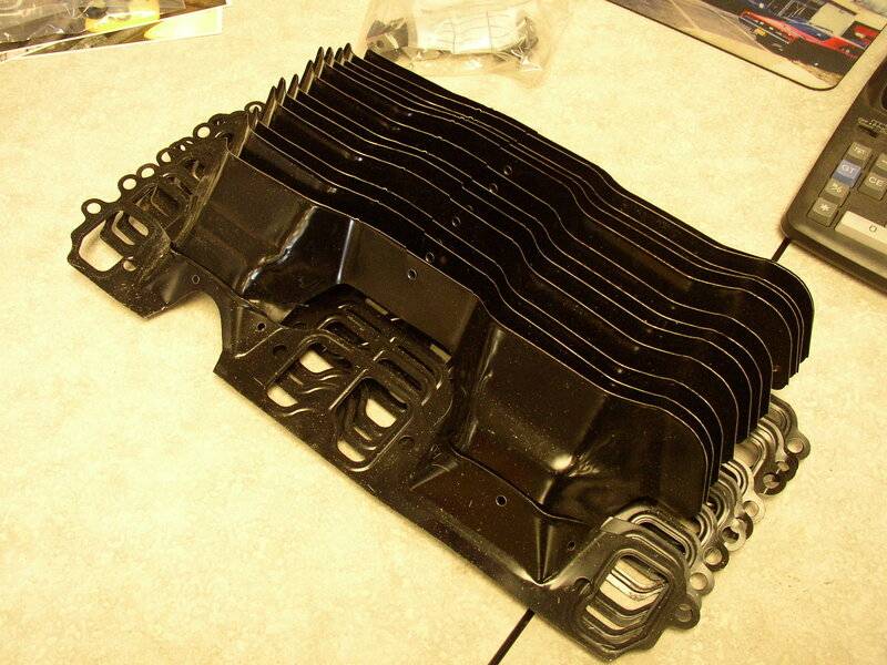

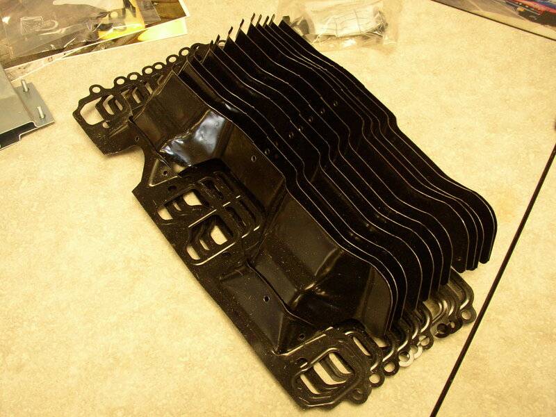

And to think I bought three back in 78 or so and they were $7 each (McCord) I think. And, I got the pass side one too. Both still on my car and my one spare is downstairs I think.
Far as I know 65 was the only year that came with a right side one from the factory.
