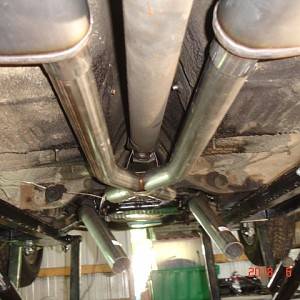

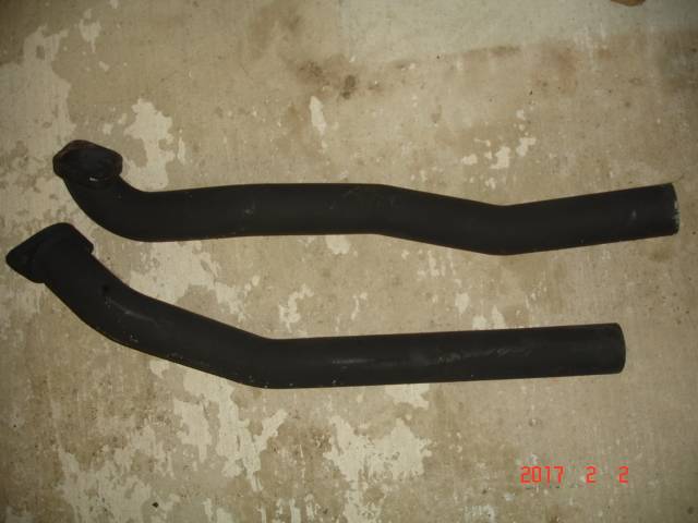

after tweaking the "X" pipe I'm happy, tti down pipes a MUST HAVE nothing has the size/fit and smooth transitions in 2.5 in !!! just wish they had em in stainless....oops your runnung headers:icon_fU:
