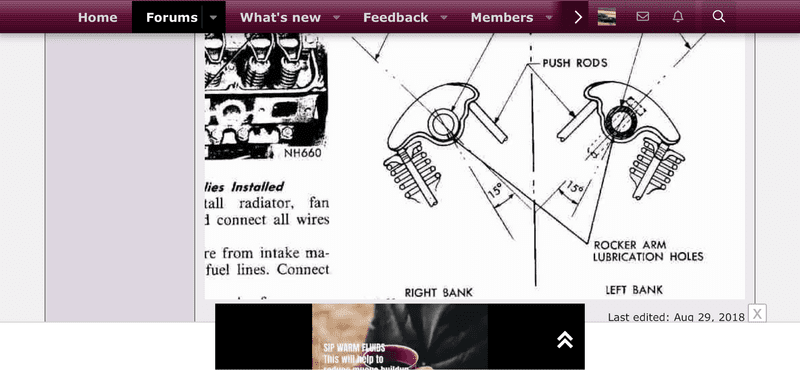

So, as a minimum, the passenger side shaft appears to be installed incorrectly as the notch should be in the back.
Your right! The shaft is the wrong way. Can Should I reverse the shaft and maintain the rocker positions/orientations?

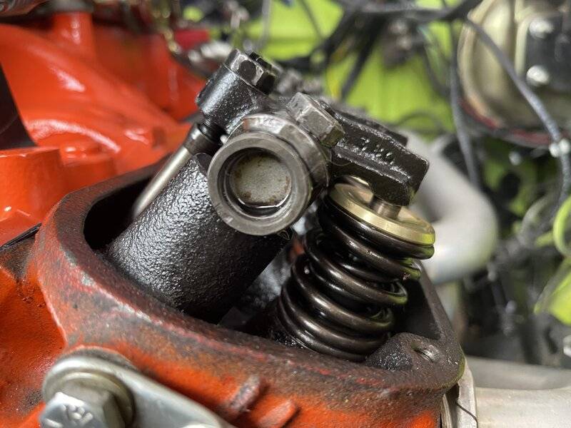

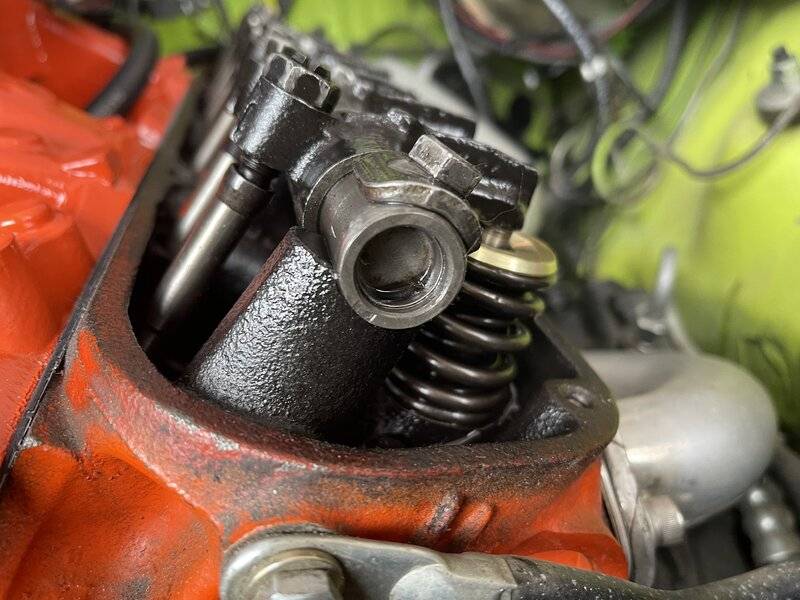

After very careful inspection I found a very low relief notch in the driver shaft towards the front pointing to the engine centerline as the fsm states it should. See pic

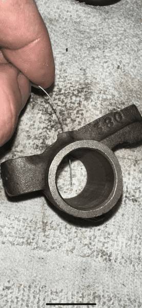

Those are 273 adjustable iron rockers. That’s a good rocker and about perfect for your application. There are two oil holes in them and you want to run a wire through each one to make sure they’re clear. Then do all the holes in the shaft.

On the rocker shaft installation. Here's how they install. Passenger's side, the notch in the end goes to the REAR and DOWN. On the driver's side the notch goes to the FRONT and DOWN. Driver's side appears to be correct.

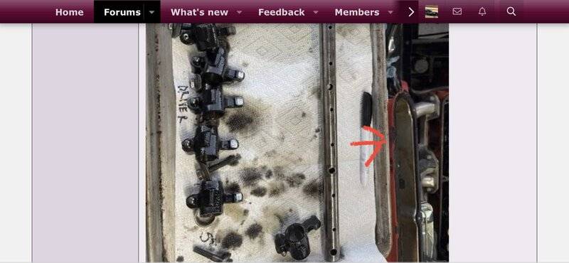

Better shot of end of shaft?

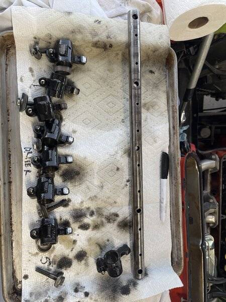

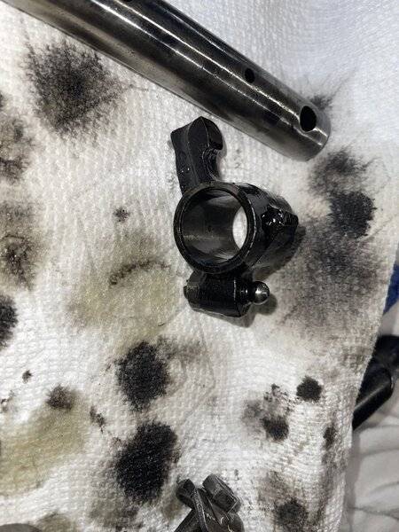

So I have removed the shaft and inspecting it. Are the rockers compatible with this rod? The rockers have teo small holes. Do the small lifter holes have to align with the hole on the shaft at some point to get flow? Does this all look right?
So you see how the bolt holes are not inline with the oil holes? You want the oil holes down and more towards the valve springs.
Remember the shaft is upside down in the picture, but the arrow points to valve springs.
The rocker adjusters seem to be all over the place adjustment wise. They also seem awful close to touching the spring retainers. Just an observation.
When I installed the shaft I did it with the alignment notch pointing towards the center of the motor for the driver side notch in front. Then I verified all the oiling holes pointing down. There is nothing else I can do with respect to geometry or alignment…..
The notches are an indicator of the location of the oil holes. Know the orientation of the oil holes themselves and you KNOW they are correct. If the oil holes are down and biased towards the springs they are correct. You don’t have to worry if your notch is a real notch or the notch was machine incorrectly or anything else, because you cut out the middleman and know where the oil holes actually are.
