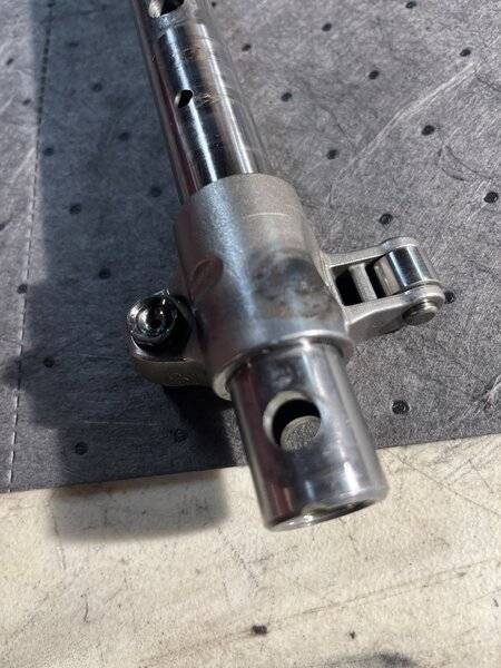

So guys what is the difference between the shaft with 2 holes per rocker and one? Could this be my oiling issue?
I’d rather have one hole. That’s all it needs to live the rocker at the shaft. Just banana groove it.
I’m not a big fan of adding oil leaks at the rockers. For what you are doing you’ll get all the oil you need for the rockers and valve stems and all that with the oil flying around in the rocker boxes.
If you had 340 pounds of spring load on the seat and you were trying to make power at 8500 then yeah, more oil on the springs and such would matter.

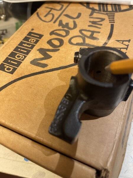

Thanks Ill measure them. Just ordered a bore hone for the rockers.
Most of the aftermarket rockers have a groove around the inside. This negates the need for a banana groove. I wouldn’t condemn your rockers. If the shafts are pretty worn, maybe new shafts. None of this equates to you oil question. Don’t want to scare you, but having a rocker seize to a shaft can be BAD. The galling can progress exponentially. Now that is a hard stainless rocker on a hard shaft. Also on the next generation the bushed the rocker. Funny, that shaft was and has never been orientated correctly. That rocker is welded to the shaft, so it hasn’t moved. Aftermarket rockers have a groove like a main bearing groove. So the location of the oil hole doesn’t matter.

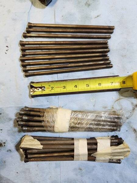

I ordered an 8” caliper to measure the pushrod. I hope that will help me identify what I have.
Great thanks.
According to my trusty 1979 Isky catalog, the hydraulic lifter pushrod is 7.265 and the solid lifter pushrods should measure 7.531 so I was close when I said 7.500. What's .031 on the internet??? LOL
You should be able to measure what you have and figure what you have.
That's basically a 1/4 inch difference.

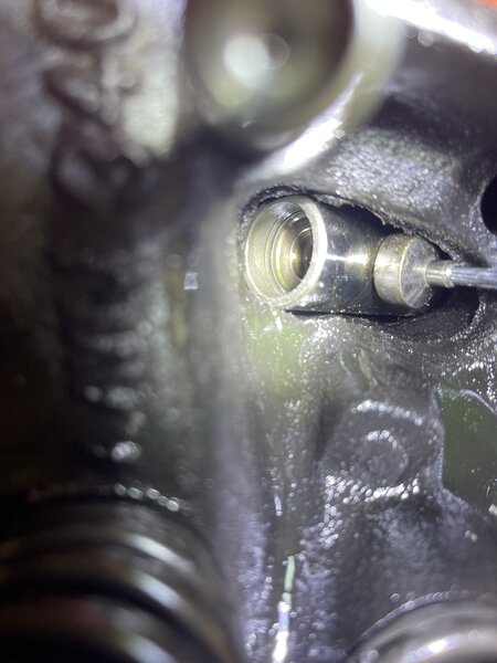

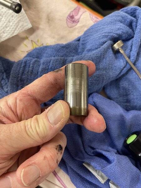

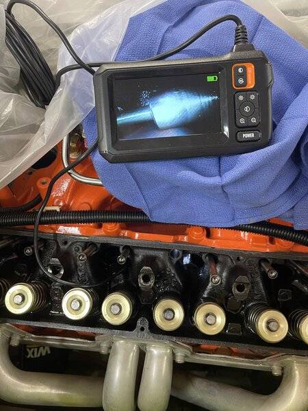

For what it’s worth. I tried to extract one of the lifters but couldn’t get it through the opening. I can try tomorrow another one if these pictures still aren’t helpful in identifying if its a solid or hydraulic type.
Yes sir! It certainly appears to be a solid lifter! Nice work!
There are teo holes in the lifter. One obviously dribbles oil down the rocker arm.
Question: Does the other hole seep oil out the screw of the rocker ball?

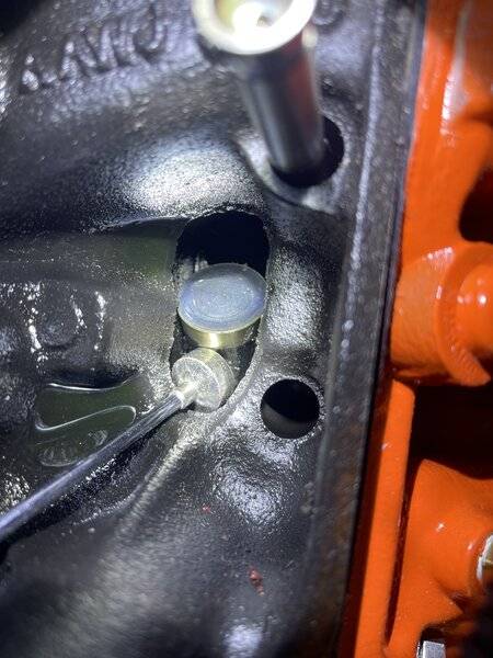

Guys! I am in trouble. My first lifter was easy to put back in through the head. The geometry was straight forward. HOWEVER I can not for the life of me get the other lifter that I extracted back into place. I’ve tried for two days and can’t seem ti get the angle right to have it slip in.
I have a bore camera on it. I am using a pushrod and a long split forceps. I’ve tried a lot and it’s being a real PITA.
Any suggestions?
Any suggestions?
That's gotta be pretty frustrating. I'd maybe try a thin telescoping magnet through the pushrod hole. Then raise the lifter up and into the bore straight down guiding it with your forceps as needed. If you don't have a thin enough telescoping magnet, maybe epoxy a small neodymium magnet to the end of a spare pushrod and use that.
Yeah been doing that. I’ll keep trying. It’s partly luck….and well if I didn’t have bad luck Id have no luck at all. Lol
