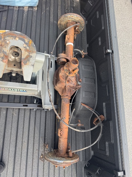

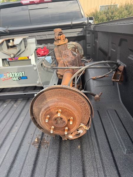

i wouldn't dismiss a ford exploder 8.8 rear axle. with a second short side axle shaft and the long side axle tube cut down by 2 7/8" it's the same overall length as an 'a' body 8 3/4. plenty of threads about the swap on here, i did it to my '68 valiant.
also they're 5x4.5" pcd, disc brakes, 31 spline shafts and in most all cases 3.73 gears with lsd. what's not to like?

Good idea! Thanks for that information. Lots of Exploders around so I’ll look into that

nice one :thumbsup: did they have another exploder you could grab a second short shaft from? if not they're very cheap new from rock auto anyway.
neil.
I didn’t even think about that. They had a few of them there so maybe I’ll go back over there and grab another assembly or just a short shaft?
if you're going to grab just the shaft i'd pull the long one from the axle you have first. then you'll know exactly what tools you'll need to take back with you. your long shaft has to come out anyway so nothing lost. :thumbsup:

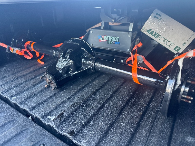

I called Mosers today out of curiosity and was quoted $5k for a 8 3/4 rear end. Think I’m a stick with this 8.8 and get it cleaned up
I considered doing the 8.8 swap in my dart for cost aspect of it but.. I managed to score an A body 8 3/4 housing and axles about 4hrs one way from me.. for probably more than an entire salvage yard 8.8 with brakes..between that, new stock 10 inch brakes from a fellow member, and a new center section from Quick Performance.. it wasn’t cheap but it was a total bolt in solution. I think I may have 2.5k in my rear axle stud to stud. Maybe a little less. All new axle bearings, housing end studs, brake lines, wheel studs… No hate here for going the 8.8 route though. Pickins are slim on A-body 8 3/4 axle setup that doesn’t cost an arm and a leg. Biggest cost was the brand new center section of course.
I just picked up my 8.8 rear end today from the machine shop. Shortened the tube , brand new axles, seals, removed all the brackets, cleaned and painted all for $1300
