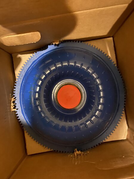

Call performance Torque converter in New Hampton. They have a nice 10” for about $400. I believe the stall is 2200/2500.
