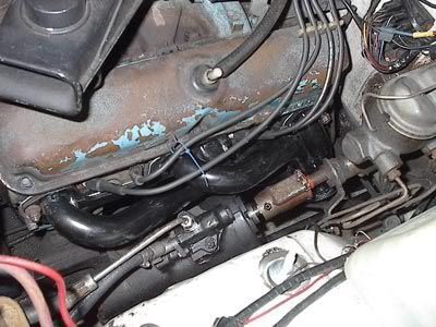

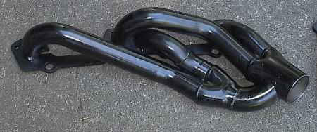

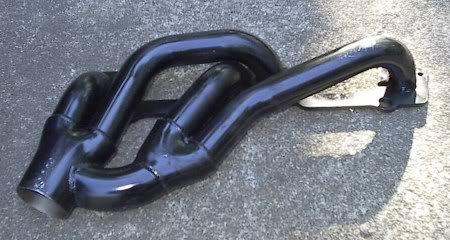

Could you post some pics. of the Spitfires?
Ok...here are some pics of the spitfires when i first got them and installed them on my original 318.
I bought them in 2002 so they may have changed a bit since then. They fit the 67-76 type body very well.
