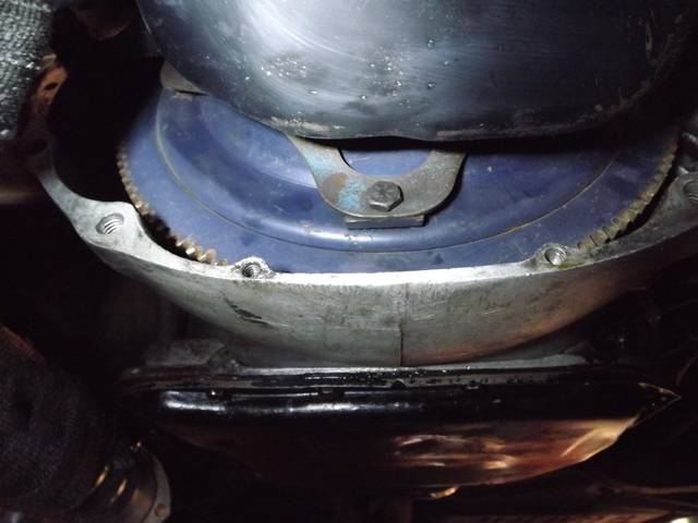

Hi, new to the Dodge dart and have an issue with engine vibration over about 1500 rpm. Now a little background first , its a 360 engine mated to a 727 transmission , im based in the uk and bought the car last year from Texas. Now it wasn't an original 360 ( I wish) or even a v8, car was originally a slant 6 904 box and 7 1/2 rear axle. someone has spent a bit of money uprating the back axle to 8 3/4 fitting a 727 trans and rebuilt 360 engine, most of it looks new is recently rebuilt, i think it was a stalled restoration, i got it from a texas classic car dealer.
now back to the vibration, the car is not not UK legal, so i cant take it for a run. I've read loads of threads on here re harmonic balancers and internal and external balanced cranks. ive tried the obvious and removed drive belts, checked firing order, plugs firing, exhausts not rubbing on body etc. I now started to look around the crank balance, the front pulley looks to have an external balance and ive rotated and looked all around the converter and cant see an balance weights, so i'm thinking I will need the B&M balanced flex plate, as it look to be a stock flex plate. any ideas or suggestions?

Or get a B&M flex plate for a 360 if you don't have weights. Did you rotate the converter to see if there are any weights? The balancer looks like it's from the late 80's or early 90's 360. Is this a magnum or premagnum engine?
I think he should look into the proper 360 torque converter with the weights...
I see a few chipped teeth on the one that he has now (unless that's just a dirt/grease spot)... If that is lined up with the starter after he turns if off, it may not be able to turn the engine with the starter... I would get a new converter for sure...

I will recheck the converter , but im sure it's fine and that is just as shadow in the photo.
It vibrates in neutral, park and in drive (I had a sneaky drive down the road) it feels like it not running on all cylinders but ive checked the plugs and leads and checked all firing. I'm going towards a balance issue, as I think I see external balance on the front and non on the rear. The engine I think is's a late 80's 360, I have a photo of the engine number somewhere I'll post up a photo of it. Only other thing to thorw in the discuss is at present its running open headers as i need to make up the exhaust, but i can see this causing the issue??
Ive spun the converter all the way round and cant see any welded on weights.

ok thanks guys, think i might drop the transmission tomorrow to get a better look at the converter and flex plate setup

Not all TCs have drainplugs. No biggie, just crank some heat into the welder.The weights only need to be tacked on;but the tack has to be serious.If it flies off at redline, it will do a lot of damage.
You can remove the weights from a spare TC, by grinding off the weld.But note where it/they came off. They have to installed in a very specific location on your present TC,AND they have to be of a specific mass, according to what the reciprocating assembly dictates.In other words;you can't just weld on any weight, anywhere!
Furthermore, you have no way of knowing what your reciprocating assembly wants. If it is not stock inside there, it will want a non-stock weight welded on. So;some experimentation may be required. Or some research, by/from the former owner.The location to weld the weight on may not change significantly. But the mass may. You gotta start somewhere.

The converter could be ok. I would try the b&m flexplate for external balance.
