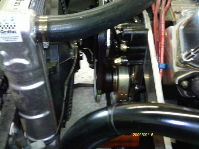

youll have to space the alternater out, longer spacers in the back, an easy fix then theres the crank pulley to deal with, I had to space mine out 1/4 inch due to a 1/2 thick motor plate, if you have power steering and or AC then thats a few more probs to deal with. Dont use 1/2 inch LOL
http://www.forabodiesonly.com/mopar/attachment.php?attachmentid=167860&stc=1&d=1281258020
Mill the water pump housing down 1/4 of an inch,the thickness of the plate. This will align the pullies and use a good waterpump. I had good luck with flowcooler w/p.
There is a factory crank pulley that works without spacing using a 1/4" plate. I picked one out of the parts pile for my buddies 440 Dart. I'm sure it was the last one I had...
