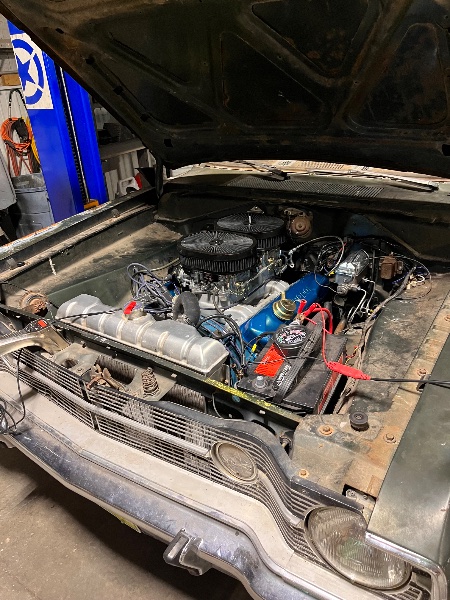

Moparpuller - please post some photos of your set up. Considering an in line dual quad set up on a 383.
Sorry just saw this. I will tomorrow. Was able to mess with it more tonight. I have gotten it balanced pretty good at idle. Cruising is still an issue. If I run at around 3,000 it runs really smooth and and the afrs are pretty close. If I let off the throttle much they get a big spread between the 2 and it will start running rough till I bring the rpm back up

I put my Weiand 8008 on it for now. With one of the ede 650s. Will probly end up getting a Holley 750vs Photo attached for the guy that wanted to see what it looked like
