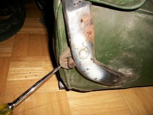

If you seat is like this one all you have to do is remove this peice (the screwdriver pointing to). Its held on by a small allen screw and a snap ring. The only drawback is there is nothing to lock the seat in its upright position. 100_0322.jpg
A Full Bench (Single Piece Back) cannot be converted. The Split Benches can. As was said above.... You need to find a Latch Assembly to bolt onto the Backs after you remove the Lock Bars. Not having the Latchs can kill you in an accident!
