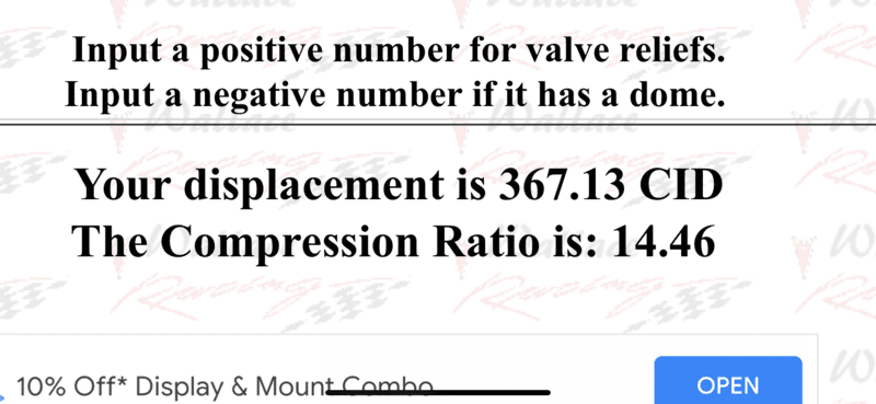

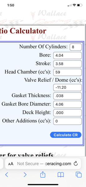

If he had the KB 191’s, that would be different. 11.20 cc dome.
My bad here. I was thinking of a stock 3.58 stroke with the KB 191’s. It would look like;
And what fuel to use here?!?! LMAO!!!
