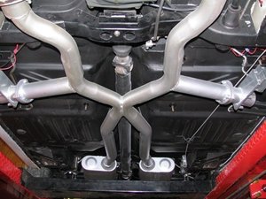

I just got mine done and have a 2 1/2" SS formed X pipe with TTI headers and electric cut outs going into Flowaster 40 mufflers
I was wondering if I had enough room and it turned out great
I'll get some pictures and post soon
this is what it use to look like with the hooker headers
X pipe made at the muffler shop, cutouts in the wrong place
