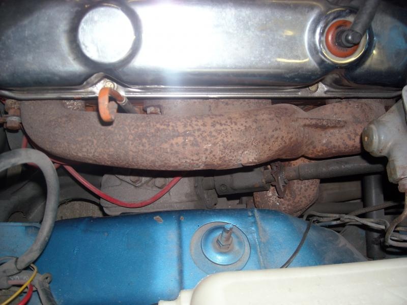

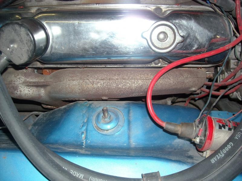

just a couple, I'll get some up of the whole car, I got all the front suspension in on wednesday, and have tie rods and pitman/idler arms coming in on tuesday
If thats a real 383 4 speed car just make sure and not cut it up.It would be a very rare car.
To all of my knowledge, it is, but when the guy got it, he took the engine out for a dirt tracker in exchange for the shell, it has the 383/formula S emblems on it and a clutch pedal (looks original)
