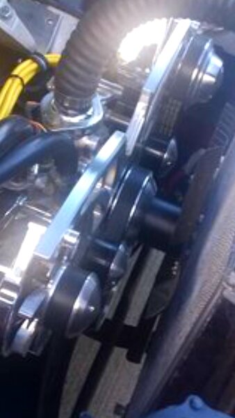

Here is a tight tolerance setup on a performance 440 running nice and cool. 86ed the electric fan and flat shroud and all is good now running an 18" mechanical blade.
And no shroud, running cool.
