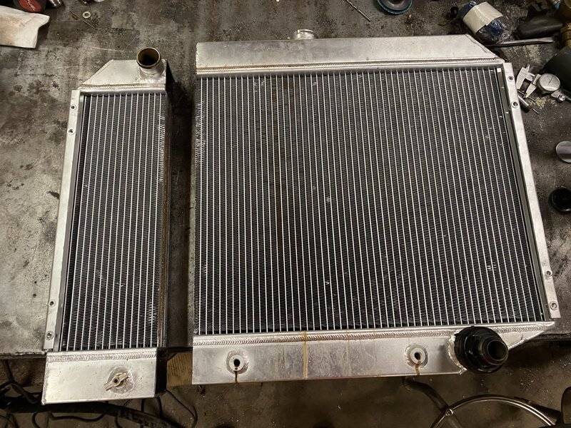

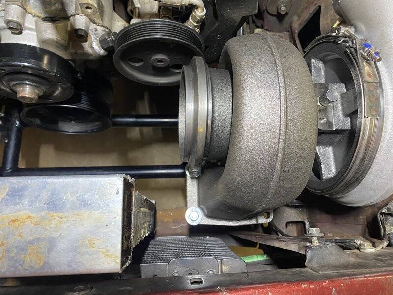

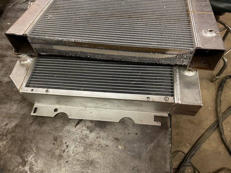

Small update. I’ve got the hot side done minus wastegate placement (I know where it’s going to go) and finish welding 2 tubes but I ran out of filler rod so it will be the weekend before I can get some shots of that. I did cut my radiator to see how everything is going to fit. I ended up taking 6” out of it and believe that will give me enough clearance even with a shroud and fan. I don’t feel like I’ll have any cooling problem whatsoever, but if I do it will probably be at idle in which case I will install a c7 vette fan. They’re 14” SPAL brushless and 600w so they move a TON of air. You can pick them up straight from GM for like $300 but require PWM- signal which won’t be a problem as I can use the Holley to control them but if others want to go this route you will have to purchase an external controller to make everything work. Snapped some shots of the rough cut on the rad and how it looks roughly bolted up. Still have to dress everything up and add the flat plate that goes on the ends to protect the fins.

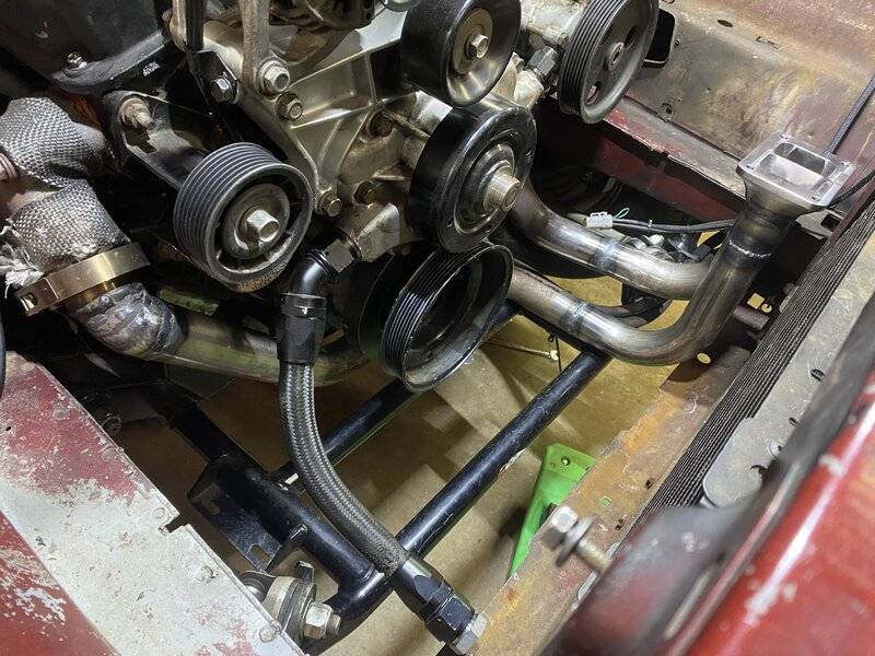

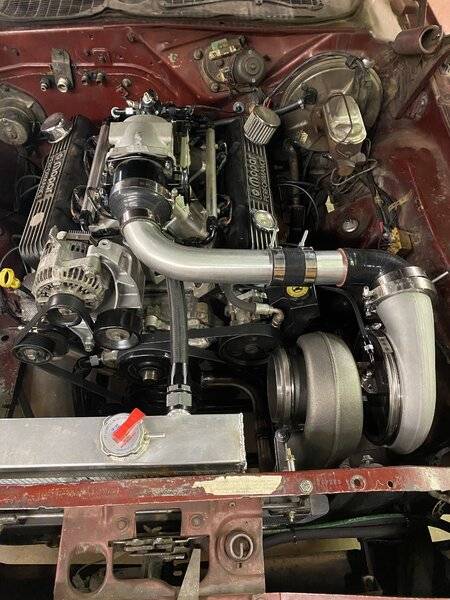

Hot side is done. Everything is setup to give max clearance around the accessory drive and be low to help alleviate heat issues under the hood. Only going to run a single 50mm gate. With the priority it has I think I’ll be alright. We shall see anyway. If not I may use the BOV like a cold side gate. It’s gaining in popularity and some folks claim their stuff spools faster.
What size are the primaries? They look small, does it spool faster, what about back pressure, etc etc .
Many questions, as I've got a GT 45 for my 65 Barracuda. I've already decided to mount it on rh side to exhaust thru rh inner & get all that extra heat out. Any accessory placement ideas welcome.
2”. Forcefed86 on the turbo forums made like 1000hp with 2” fully divided hot side on a 4.8 and went 160mph to the 1/4 and said spool was much faster than 2.5 or 3”. If your not fully divided though I’m not sure how small you can go.
1-5/8 is a good size for 318 tube header primaries, so sounds interesting, however
4.8 LS doesn't really prove it. I'd like to see you build one with larger tube's & test them back to back, only changing pipes. It sounds real good for street use, which is what I need, but for 1/4 mile, will it work @ higher rpm or lay down?

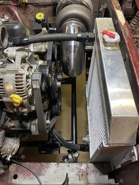

Got the radiator welded up finally last night. Took me 4 different attempts before I was able to get the tank sealed without blowing holes in the tubes since it’s so close. Layed my 5” 90 on the exhaust flange and will have to get creative with the fan shroud but everything will clear. I thought I would be able to sneak a 5” between the kmember and strut rod but it’s never going to clear so I will reduce down to a 4” at the strut rod and run that the rest of the way. With it being short I think I won’t have to deal with backpressure much. All my stuff for the -12 drain came in so this upcoming week I’ll finish out the radiator side pieces/ 16AN outlet and run my oil drain line. -12 is HUGE btw.

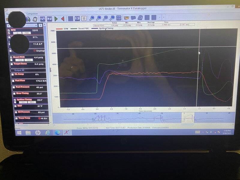

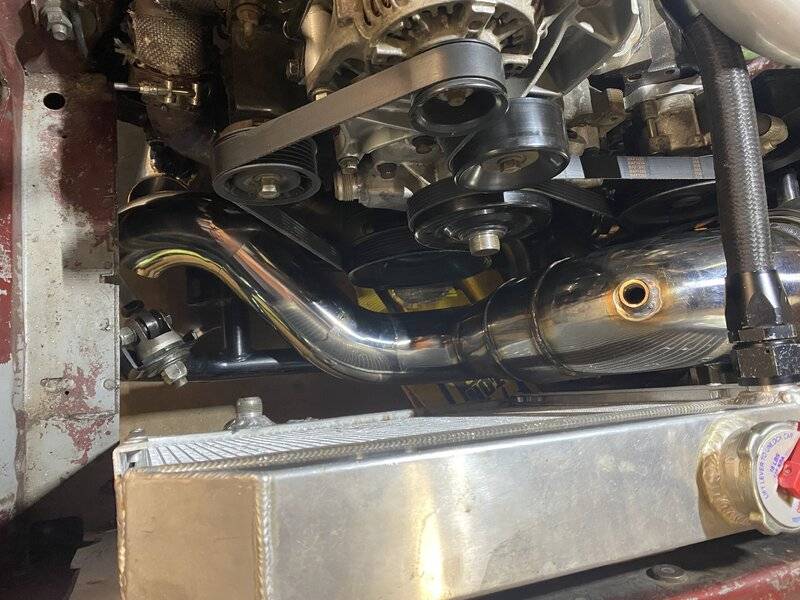

Got everything fired up last night. I still need to finish the down pipe and the cold side isn’t the final rendition but I didn’t want the e85 to sit in the injectors any longer without pulsing (this would’ve been a month). The Down pipe flange was too thick for the vband to clamp so I got a guy from working turning it down to fit. Put it on the chip and it made 4.1psi in 3.2seconds when I lifted. Timing manipulation and fuel should allow me to make boost faster as well as more leave rpm (this was 3200). I have a very serious worry that the converter is going to be entirely too loose. But, those are minor things I can get fixed with datalogs and showing the converter place exactly what it’s doing. Overall I’m super impressed. On the datalog green is boost, red is rpm, and purple is timing
Start of dp routing. It’s going pretty smooth so far. I’m hoping I can get everything buttoned up this week and go to the racetrack next weekend. I won’t get to see the full potential due to being on a hard tire but I might can throw a decent timing retard in it and then if it mph good I’ll know what the ET potential could be on a radial.

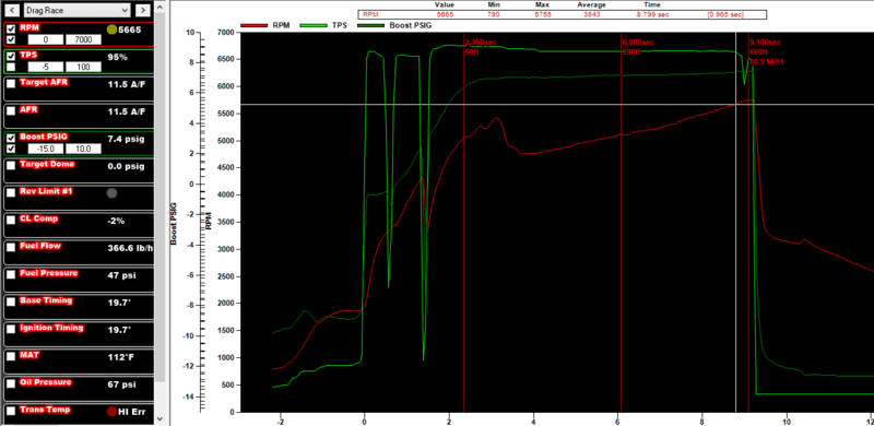

Was able to make a hit tonight. This was on street tires and no burnout so it’s obviously very lazy. Just for a guess I added 5% to the entire map in boost and added an additional 3% from 5700 up and smoothed my 5% to 8% transition(no I didn’t use the smooth feature I know it’ll get ya) I was actually pretty close. Below 4500 to 5500 I was adding 3% and then it started removing a bit around 5700. So it’s definitely making more power as I had based my fuel map off a 40* night and coolant temp of 145 vs 65* and 180 coolant tonight. I just left at like 1800 or so and had a 15* timing retard for 1second. As you can see from the TPS reference it still spun obviously. Even with a single gate boost was VERY steady and was between 6.8 and 7.5psi the whole run. As you can see I let me feathers show( I was a chicken) and short shifted the 1-2. Timing is pretty soft as well at 20*. Overall I’m very happy and think once I can get to the track on a radial and leave on some boost it might make some bacon. I do have a 4 port Mac valve as well so I can turn up the boost and I’ve already got a decent duty cycle curve to help build boost faster. Let me know what y’all think!

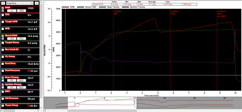

Made another hit on the street tonight. Added 1 click on front rebound, 100lb in trunk, and changed the launch retard a little to get it to try to stick the tire initially and then pull the timing. SUCCESS. Dead hook. Dropped 1100rpm on the gear change so I can turn it up a good bit before I have to worry about converter slip too much. Glad I was able to see what the converter would flash to as well. Right at 3200 and it had 11deg total timing in it right there so it will definitely loosen up. My cheap eBay fan has to go. So I’ll be getting a c7 vette fan and making a shroud to hold it and PWM from the Holley. That should handle all my cooling issues I think. I’m filling my overflow so I think I have a head lifting and then resealing once the pass is over. I’ll be able to know more once I get the cooling issue sorted to see if it was pushing water from heat or combustion. The tuning side is becoming addicting to see what changes I can make to change the ET and not touch the target boost. Speaking of which. The boost overlay was darn near identical to the run the other night. Fuel flow was within 9lbs and mph was within .3 so at least the only variable that really had an effect was the 60’.
