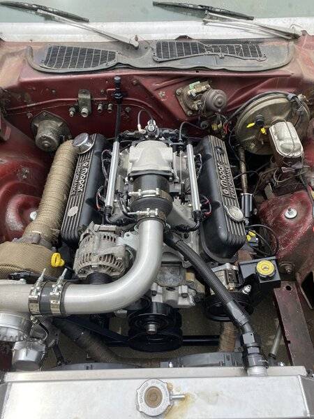

So the turbo was a eBay GT35 I had laying around from a prior project that never saw fruition. I knew it was “small” but thought it’d be fine and get me some experience. (Looking back the turbine was way too small even for a gutless 318). I started collecting parts with the intention of running it on Holley terminator X and a dual sync distributor. The more I researched I found out I could use a Jeep cam sync and a factory magnum crank sensor with the reluctor modified for single pulse per fire(I have a pic showing where I welded up 4 of the air gaps in the reluctor as the factory 8 was too many) . This was great because it meant parts would be easily accessible if something failed 1000 miles from home. I purchased an engine harness from HCR innovations for a 58x LS engine (cam and crank reference are 5v like Chrysler stuff, I did have to put the appropriate connectors on the harness and can provide part numbers for NEW connectors not junkyard stuff) and that’s really all that’s needed to make this whole deal run other than a leash 8 circuit relay board to control fans, Transbrake power, lockup, fuel pump etc.
I built a A500 with a cope Transbrake valve body and Hughes converter so I could enjoy OD and lockup while running these events.

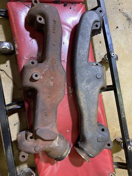

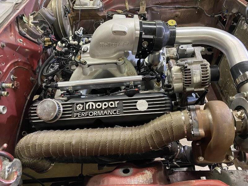

The motor is a 98 5.2 out of a Jeep. It has a driver side truck manifold and a Jeep passenger manifold. I cut both ball and socket ends off and welded vbands on. Stock camshaft, Indy “x” heads, and a efi super victor with a Holley elbow. Hot side was 2” into a 2.5” merge. Non intercooled and running E85. I originally started with a .68 t3 flange turbine housing. It lit off VERY quick. Like 2000rpm it made 5psi. I swapped to a 1.06 turbine housing and picked up about 5% VE without changing anything else and spool characteristics didn’t change a bit. This was indication #1 that the turbine side was severly undersized even for a 200hp motor.

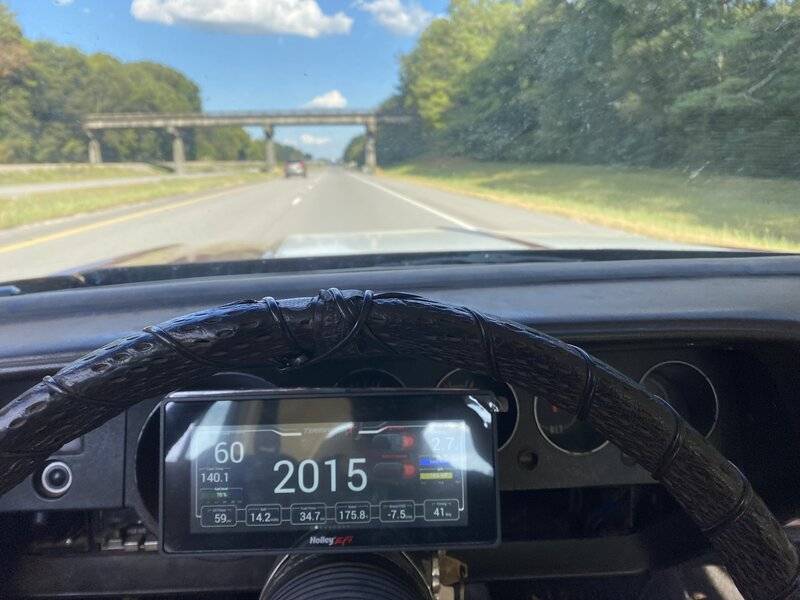

cruising down the highway with OD was amazing. Everything stayed cool and having the Holley pro dash made things super nice with the virtual switch options built into the screen that you can custom configure for things like boost control, timing retards, manual fan activation, it’s really almost limitless.

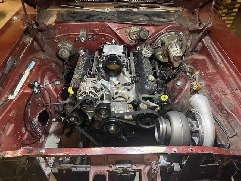

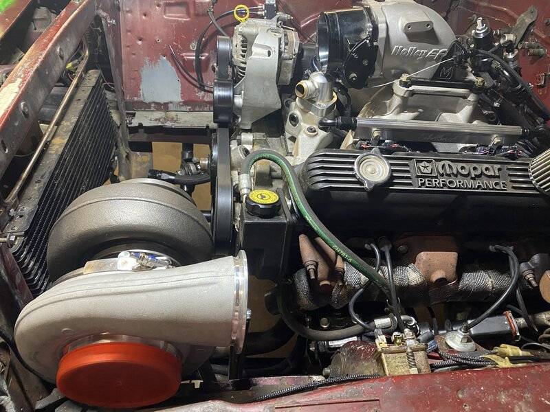

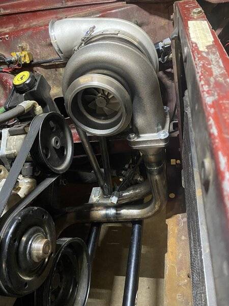

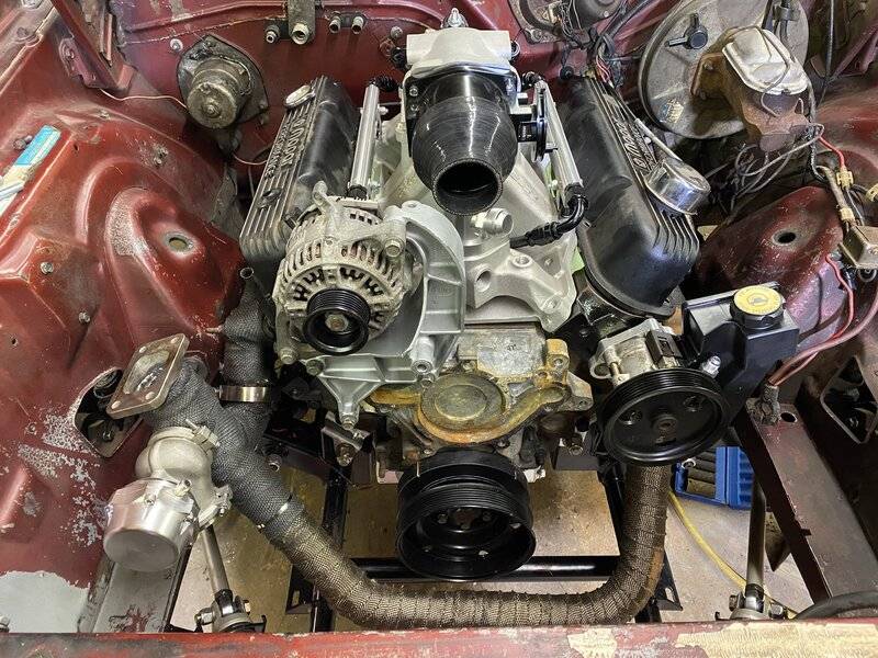

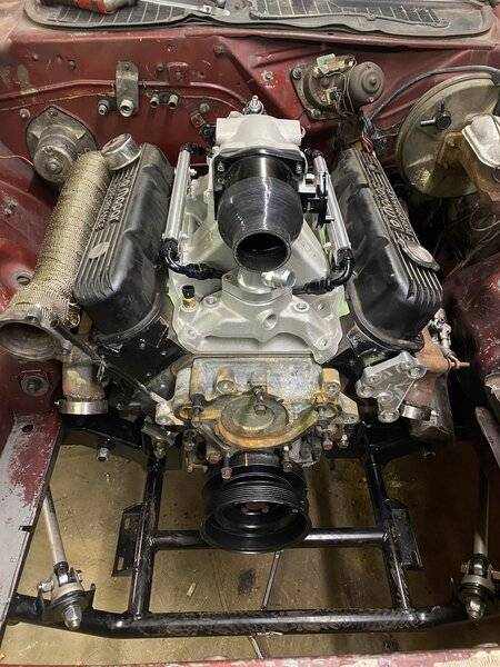

About October of last year I saw the eBay s475s were getting really cheap ($208) and decided I’d get one and slowly collect parts to put on a “good” motor one day. A couple weeks ago I found a thread on theturboforums where a guy had put a t6 S475 on a smog 305 (170hp engine) and said it actually made 5psi by 3500 on the foot brake. This got my gears turning on if I could make things work for my engine. Fast forward to this past weekend and I was “looking” for stuff to do and decided I’d pull the radiator and see exactly how or if I could get this thing to fit. I’ve got Some pics of the gt35 beside the new turbo just to give a rough idea of how massive this thing is. (it’s basically a gallon of milk for size reference). Things snowballed and before I knew it I had pulled the old turbo kit off, cut hot side pipes and began fabbing the new hot side for this turbo to go on. I am going to cut my 26” radiator Down to 16” to help clear the shear size of the new turbo. I don’t *think* I’ll have any issue with cooling as 16” mustang radiators are very popular with the turbo LS crowd and some even get by with Honda radiators if they have a good fan. Plus being on e85 will help with cooling as well. Hot side will now be 2” fully divided. Down pipe will either be 5”reduced to 4” at the firewall and out the back or 5” to dual 4” in front of each fender (think bullhorns,but again no cutting) I will initially run non intercooled again but will eventually pull the grille support out to fit an air to air intercooler. I’m not worried about how it acts on the street as far as “fun factor” and spooling goes. At this point I strictly want to run a number at the track and run sick week etc. and see just how far a stock bottom end motor can go. The SBE record currently is 10.25 and I think I could get there with a cam swap and 20lbs based off of the current record engine combo. I’ll slowly be updating here mainly on weekends due to not getting a lot of time to work on things during the week.
