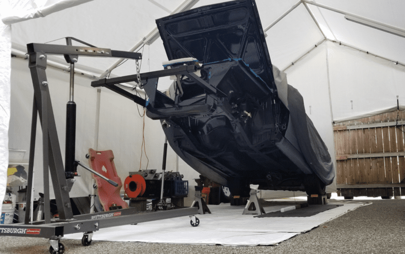

Testing out the US Car Tool car lifting tool.
Lifts plenty high with the rear on ramp/blocks.
6.1 and 727 are on a US Car Tool K-Member cart.
Didn't have a transmission mount and none at the local parts store.
Amazon Prime is on it's way!
