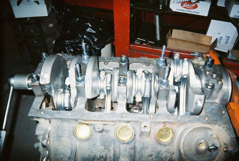

I am in the process of planning my factory 340 block to withstand 600-625 HP...
-Forged MOLNAR crank and H-beam rods .
-Diamond pistons ( lightweight )...
- ARP studs
- Internally balanced .
THe ONLY thing i am not sure of and was hoping somebody would of brought it up is one if these 3 below for mains .
1. 2 bolt billet mains
2. 4 bolt billet mains with splayed outer bolts.
3. 2 bolt Billet aluminum mains ...
My first choice would be aluminum mains due to helping in diverting harmonics away from webbing ? Apparently there is no life span like aluminum rods have ??? Any suggestions ?
I'm use the Milodon ductile iron caps, but don't run the outer 4 bolt provision. The OEM block webbing where the outer bolts go is too thin already.
I had a set of BCR two bolt caps on our filled stock block 340. Being those are few and far between I'd go with the four bolt caps utilizing only the two bolts.... while we didn't dyno the combo, raise the shift point to 7200 and it would go 9.8's @ 136. Had about 150 passes and the rod/mains always looked great... crap leaky W5 heads ended that era.
