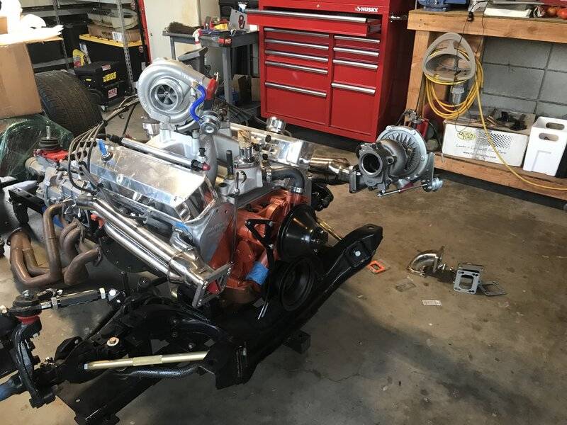

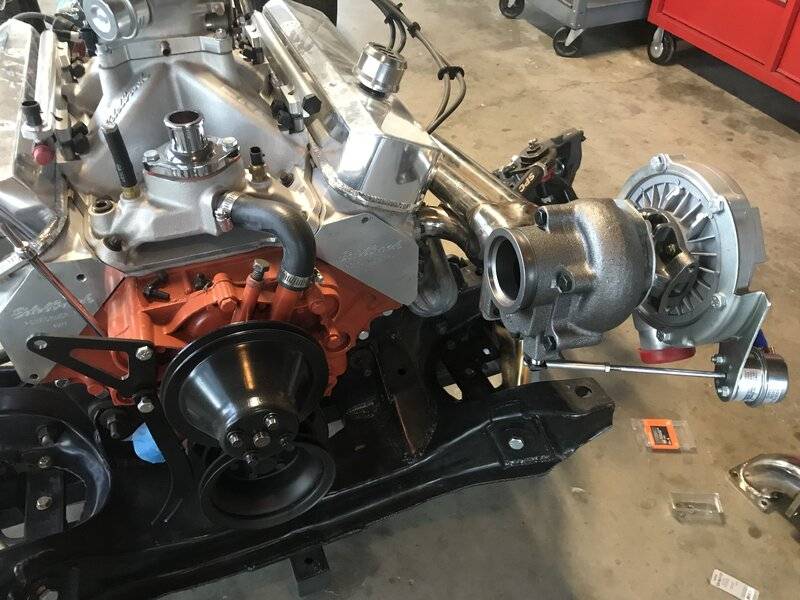

When I get busy on my 70 ‘cuda I think I’m just going to have someone build something better than this EBay turbo set up I had mocked up. I ended up selling the headers and turbos. This engine wasn’t even built for boost but I think it could take mild boost in its current configuration with, as mentioned, dialed timing.
The engine in the turbo pics on an IMM 4” , +.060”, 340. 10.5:1, all forged. 550hp N/A on Bryan’s dyno.

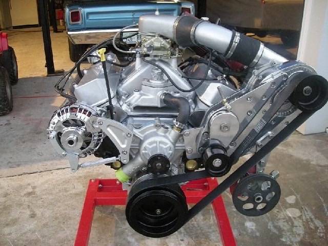

I might just freshen up the 408” with the Procharger. It’s 650 on the Teuton’s dyno. It was really fun on the street and I only ran an MSD-6 and water/meth. It was like going wild in a Hong Kong brothel without a rubber and NOT getting an STD. I never hurt it. Life got in the way and the car got put up.

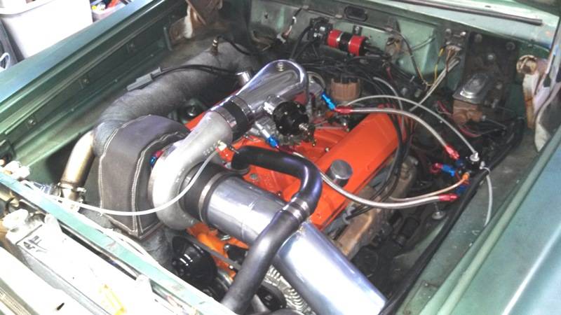

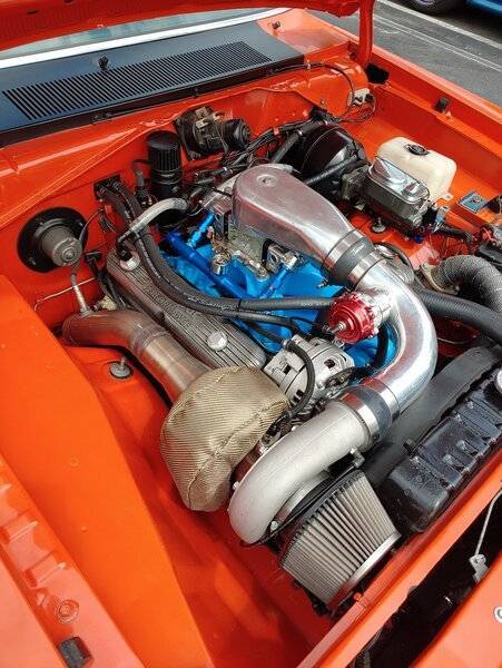

That's Scott "Dizuster"...he's using my old motor for NSS racing now. It was a magnum block and crank with good rods and good pistons. Blow-thru carb e85 and cnc eddy heads and custom hyd roller. Ran 9.55 @ at least 3750lbs. but it was being leaned-on to get there 22-24? pounds and it hurt things. He can better chronicle the build and it's evolution but here is an early pic of the set-up. That motor got repaired and rebuilt and is now in the green Duster that was at Autorama '24. I know it's an ebay turbo but he upgraded to a billet wheel along it's evolution. The 5.2L turbo 'kit' program is in Jerry's orange Demon and that is a good model for CHEAP but good power...I think he put 450HP to the tires about 11# of boost and he hasn't had it to the track yet tuned.
