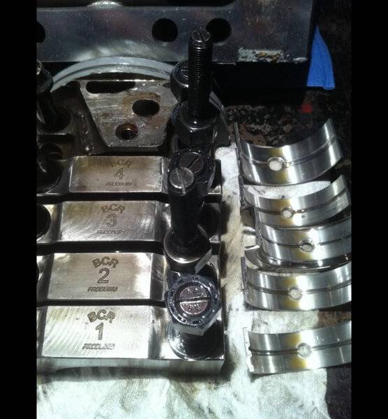

to be honest you rarely hear about block issues with the LA. Our old 340 block served us well until the Eagle rod exited. Mains looked like new when it expired just short of 200 passes.… but it led an easy life. My dad short shifted it for most of its life as the car wasn’t 9.99 legal. Think he was shifting at 5800. We ramped it up to 7200 one time and it clicked of a 9.7. Prob was 9.5s in it if the damn W5s wouldn‘t have broken our hearts. Our block was 1/2 filled and we did run aftermarket main caps.
Were those steel or aluminum main caps? Just curious. They do look pretty stout.

They were steel. Very short run on those caps
I know I will never go through changing caps on a block again but if I did I would go with aluminum. I don’t think those 440source billet caps helped my 440 life one bit longer and if anything shortened that blocks life.
