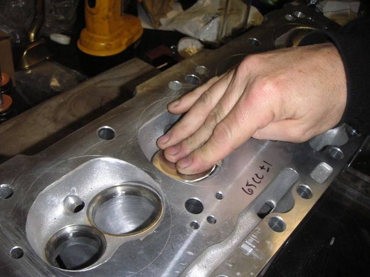

If you’re still concerned about the compression with your available fuel, you could smooth & polish the combustion chambers. This will increase the chamber volume by a few cc’s (around 4-5cc) and get rid of any sharp spots, casting texture etc. Also will drop the SCR down a little as a result.
@mopowers I would use the 0.039’’ gasket option. - I’m using this gasket.
Heads are Trick flow, so they're already smooth as hell. I'd be a little hesitant to touch a carbide or tootsie roll to them. If I attempted to remove 5cc's from them, it wouldn't be pretty. haha!

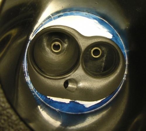

Yeah, I did mine by hand just for that reason! Turned out really well. The chambers had the CNC tool marks in the chambers, which I polished out. Wish I had a photo.. oh well.
I'll also come back and add this. After I got mine all tuned and running without detonation, the issue cropped back up a few months later. Turns out, the carburetor had loosened up on the intake and it had a vacuum leak. So, that tells you the small amount of change that can lead to it doing it again, so don't try to lean it out looking for power. I advise running them a little fat anyway. Not 450 pound fat woman fat, but just a little baby fat.

Aluminum heads, sharp edges chamfered, chambered fitted to bore. Heads cc’d, piston to deck height measured.
