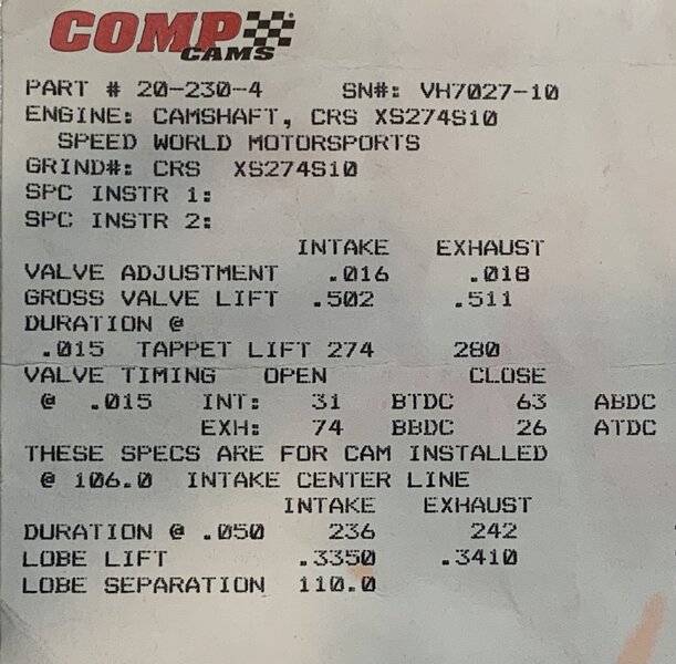

Is this the one? I'm failing to see how this is any different than the cam card. It also calls for a 106 ICL. Can you explain it for my dumbass?

Right now you have the numbers at 110 LSA and 106 ICL and it’s advanced. That’s the 4 degrees you’ve entered where it says advance.
To move the overlap triangle just change that 4 degrees in the advance box to 3 degrees and you can see the overlap triangle either get centered over TDC or it will at least move to the right a slight amount.
Keep lowering the advance number by one until you see the overlap triangle centered over TDC and when you get that number that’s where I’d install the cam.
I’m not sure without doing it myself where that would be but just play with it and see what you get.
Edit: I just used your numbers and it looks like to center the overlap triangle you need to be on a 108 or a 109.

What's advertised (seat) intake duration on the cam?
274/280

Thank you for the explanation. I fully understand the concept of overlap. I just didn't (and maybe still don't) quite get how the center of the overlap triangle wouldn't line up with where the cam card puts it. I'm okay with not understanding that though and will take you for your word.
Though I'm absolutely not looking for every ounce of power out of this combo - not even close - I actually wouldn't mind installing the cam a couple/few degrees retarded. That would lower my effective compression ratio couple tenths.
Thanks. Strange they list it at 0.015" valve lift. I added a couple degrees to compensate and looks like your dynamic compression ratio is in the 7.8 range. That's right around where I'm at with my iron headed 340 and I've never had an issue with detonation. I wonder if there is something else going with the tune or something.

Running your cam, the 110/106 advanced the cam so it’s technically straight up. It’s advanced.
I moved it 2 degrees (2 degrees retarded from the cam card) and it looked centered.
To me, that’s where I’d install the cam and not where Comp wants it.

Thank you. It looks like you're right. In my case, it appears as though 1-2* is the sweet spot. I was thinking installing any cam "straight up" would center the overlap triangle, but I guess that's only the case for non- split duration cams. When the cam has a split duration, it's understandable that the overlap center would be skewed to one side at straight up. That is even more prevalent as the split in duration gets larger.
Seeing's how my timing set allows for 2* increments, I may opt to install the cam ICL at 110 (-4 from cam card spec). This is beyond splitting hairs in my case, but interesting none the less. At this point I'd rather err on the side of less effective compression to help with detonation resistance.

So, you're talking about moving the ICL ONE degree. How much will power benefit from THAT?
In my case, 2* means going from 8.25 DCR to 8.12 DCR and 4* takes it to 7.98. That may make the difference in pinging or not. Any power difference means squat to me for this build.
Ok, I’m back on my iPad so I can actually see something.
I just ran your numbers again and it looks like a 109 ICL is pretty close to centered up.
But…a 110 ICL moves the triangle so little to the retard side that I’m with you. I’d go in at 110 and send that mother.
Thats going to close the intake 4 degrees later which lowers you ECR and DCR (at whatever numbers that math is figuring DCR).
Graphing the cam timing and being able to move the timing around so I can see it visually makes it way easier for me to see what I really want.
Thank you for confirming. At this point, I'm prepared to take the block back to my machinist, zero-deck it and order up a 0.039" gasket. This will net a 10.46 static compression ratio, quite a bit more than I was shooting for but it'll have a decent 0.039" quench and aluminum heads with a good chamber design.
With my cam installed at 110* ICL, the IVCA will be at 71* (actually the .006" IVCA, so it may even be a degree past that) and net an effective CR of 7.98:1 (just 0.10 higher than my iron-headed 340 that runs great on 91 oct) and a calculated cranking pressure of 162.75. The calculator I use, calls it dynamic CR, but it's essentially effective CR. I've noticed those terms being used interchangeably when they all really mean effective CR. It's based on effective stroke which is calculated based on when the intake valve actually closes.
What's a tad worrisome is the fact that @autoxcuda 's combo had similar numbers and he seemly had detonation issues on the same fuel I'll be limited to. If mine ends up pinging and I can't tune it out, I'll replace the pistons or pop the heads off and go to town with a carbide. haha. I appreciate everyone's feedback.
