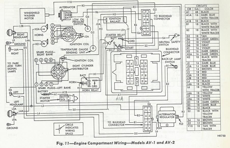

From FSM, this may help. An "inhibitor" must be some new gizmo, never heard of it!:-D Assume you're talking about the neutral safety switch, used only on automatics. Manuals use the same basic relay with this terminal grounded to case. There is an error on this drawing, A1 is not a big 6AWG but rather a little fusible link A1A, see markup.

As stated, goes to the stud on the starter relay, really can't go anywhere else given size, it's A1B on the wiring diagram. You could save yourself a lot of time & confusion by learning how to read these drawings, they tell you everything you could ever want to know on your car's wiring (at least as it was designed).
Keith, someone boogered your fusible link, see comment on A1A wire.

The thick "buss bars" on your firewall connector are marked "ALT" and "BAT" in the schematic. They have the same labels on the connector itself, or maybe "RED" and "BLK" (I forgot). You can get BATT+ (thick red wire) at the starter relay, as shown, preferably via a "fusible link". ALT (thick black wire) goes all the way to the big stud on the alternator, just follow the R6 wire in the diagram (ignore that it is called BATT at the alternator).
Those bus bar feed-thrus keep 63 & 65 cars from melting the bulkhead. Too bad they did do that in all cars.
