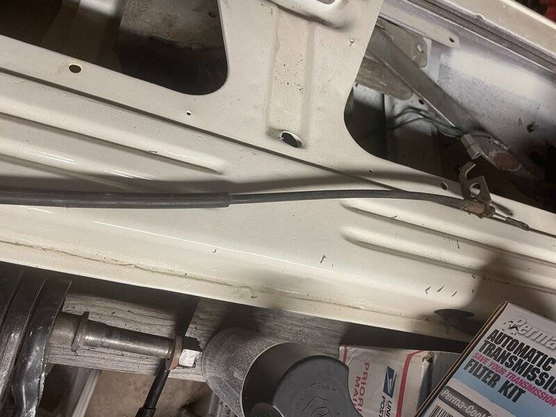

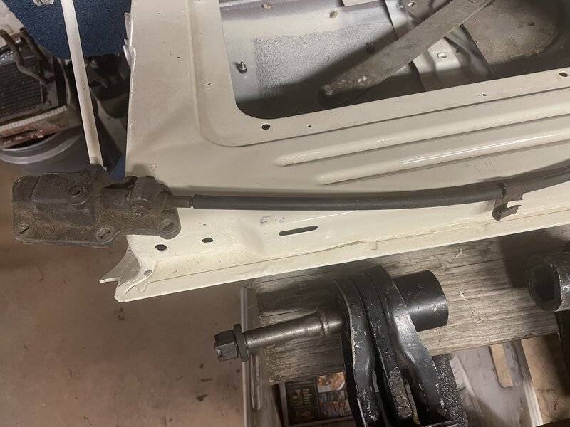

So I got the cable out. Good thing I looked in the manual, because it tells you to attach a wire to the end of it, so you can pull the new one through the floor to the shifter.
It attaches to a bracket, but it's different from the one shown in @65 Dartman 's photo. My bracket has a 90 degree bend.

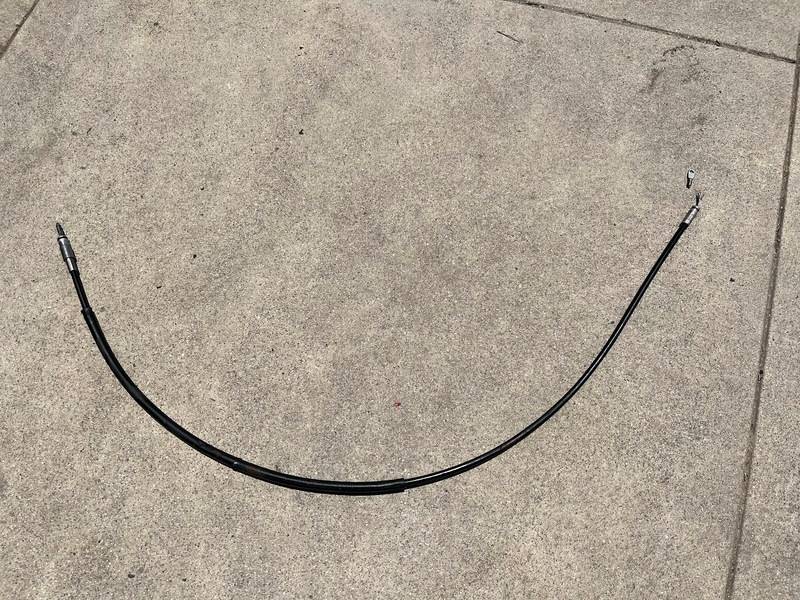

The cable (housing) is 41" long. I believe the original part number was 2461929 according to this: Mopar Pushbutton transmission cables

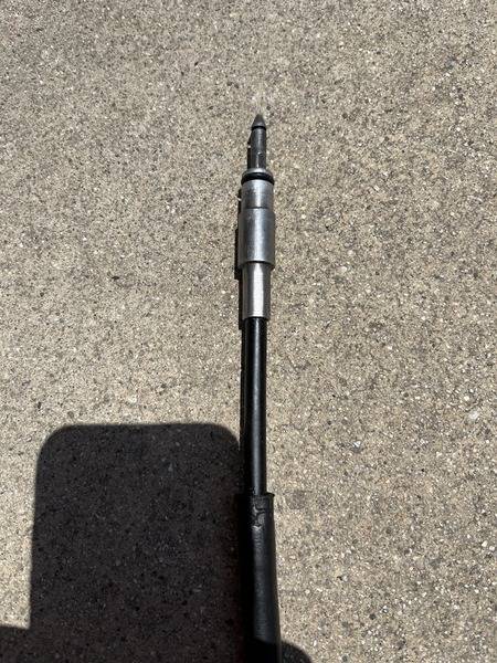

This side should be the same on all cable shifted 904's and 727's.
This side has the deep groove and a short eyelet. It appears that pushbutton cables have a longer eyelet.
Ok, so I was wrong again, the cable for the '65 A-body console is 2534 415. Anyways, the cable I got from Don is too short, it had a groove, but in a different place and I don't know what that might have been out of.

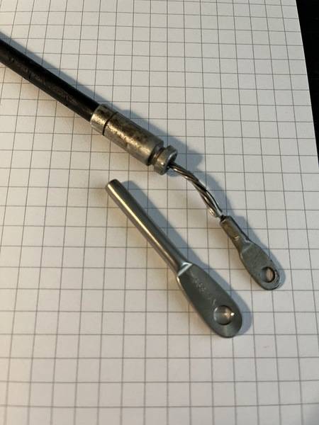

Now I'm thinking I might be able to fix my old cable with something this:
I check with a caliper and the cable has a diameter of 3/32" and the eye is 3/16" diameter. I would have to somehow crimp it. I was hoping to find something with a sets crew or so, but but haven't yet.
This might actually work. Will have to shorten the shaft and maybe drill a hole closer towards the cable. And then crimp it well. Will keep you posted.
