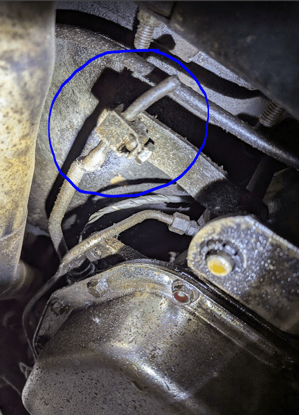

I went under the car an adjusted this from the linkage to give a bit more movement on moving it into Park..
It now goes into Park, (I believe, its on jacks but it now starts when in P) but it does not lock into place. I can bump back in Reverse because it doesnt lock into P.

Back out that adjusting nut and slide the linkage, in the above picture, till the adjusting rod does not limit the travel of the shift linkage. Then move the lever on the trans all the way into park. Next move the shifter into park till it locks. Then tighten the bolt and check to see if everything is working correctly.
