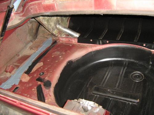

this is how bad my trunk is any suggestions?
Those are dome lights down there! I agree with the damraider cap. Make a vent tube on top of the filler neck and direct it down out of the trunk/cabin. My 65 had the factory Valiant racing stripe when I bought it (a patch of stripped paint under the gas cap where it always dripped)
