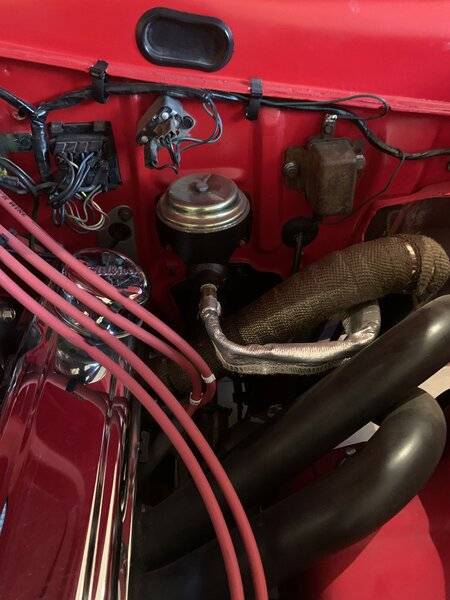

Yea, same here. I have thought about dual master cylinder with my Hedman 1-7/8 fenderwells ('65 Barracuda). It does look like an issue but to date I have not investigated. Bugs me but my car still stops. :) Mine:

I have Headman Hustlers on my 66 Valiant with an aluminum Mopar performance master cylinder. I had a stock iron master cylinder from my 72 barracuda before the aluminum one and the #7 pipe almost touched the master. The aluminum has an inch of clearance. To avoid boiling the brake fluid, i added a heat shield from Mancini Racing.
