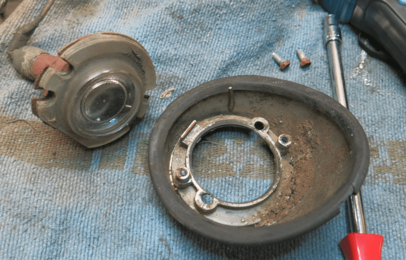

I used nutserts (installed like rivets) and countersunk machine screws which I ground the edges off to clear the housing. Worked well for me.
I guess the consensus is in. Somebody must have swapped my countersunk ones out with the ones that are/were in there when i got the car. Oh well. Gonna make 2 sets that look like the ones i currently have out of stainless steel, and then abandon the idea. Thanks for the pix so i know whats supposed to be in there.

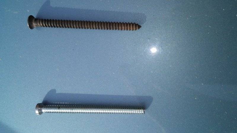

FWIW. I beleive the one in the center is original.
Chromed steel, philips, #8 sheet metal screw 1.25" long with #6 oval head philips
On the left is a #8 oval head, and on the right is a #8 with #6 head, 1.5" long from Restoration specialty Supplies, item 1932.

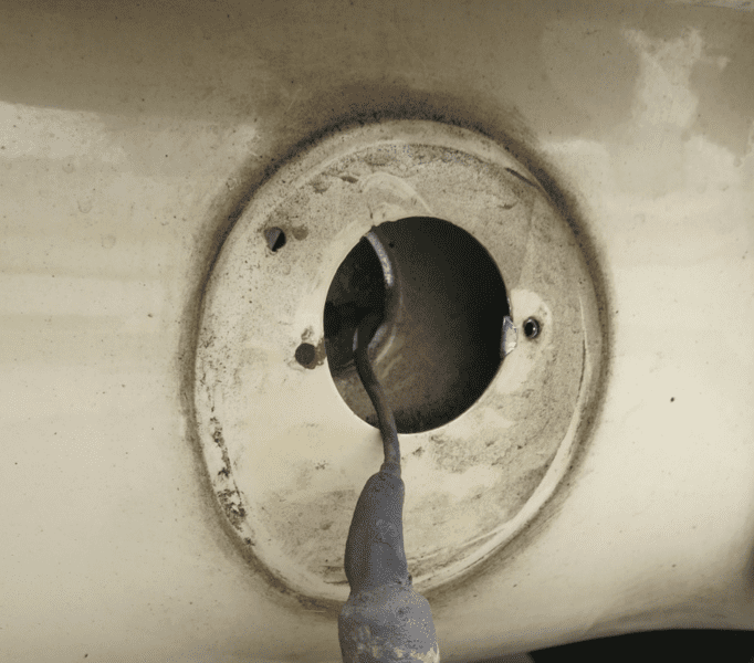

On the valence I did have to back up one hole with another piece of sheet metal.
