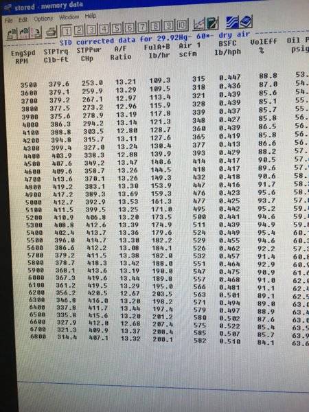

67 Cuda: disappointing dyno numbers, need some advice!

JMO, that's a 350ish HP engine on a good tune up unless the heads are exceptional on performance. With the 450 lift, bad lifter angle and rockers that are rarely at the true 1.5 ratio, the valve is likely seeing something in the .420-.425 range
About where it should be for RWHP is my guess. Might scratch a little more out on the tune up.

That's about 425-430 at the crank at your weight. There is nothing wrong with that, at all.
Depending on the dyno, your wheel HP is pretty close. I'd say 360 at the wheel is pretty close.

And I agree, those HP/Tq numbers are pretty accurate for the combo you have now, I'd drive it and enjoy it until you're ready to have the car inoperable for a month plus (could be less if you know what you're doing and get it done quick).

Ok did the compression check today, and they are all right at 140
Probably in the 8.5-9.0 CR range.
