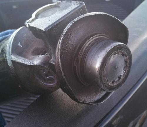

Are you going to use the 8.75 with that kind of power I was going to but decided to use a Dana 60 this was posted on YB >>>>
the 8.75 rear end will grenade before a you make enough power for a intercooler.. we broke 8.75 rear ends on the street in my friends turboed challenger... broke 3.. went to a 9'' never had a problem.. also if your gonna run leafs ditch the SS springs and get a split mono and a assassin/caltrac setup worth every penny over a ss spring..
And a few other's saying that they won't hold the power so I asked my local chassis guy and he said there a good rearend but will break he and other's said sell it while you can get some money out of it so I did , I would recommend that to you cause when you break it it's worth nothing aslong as that's all that breaks.
