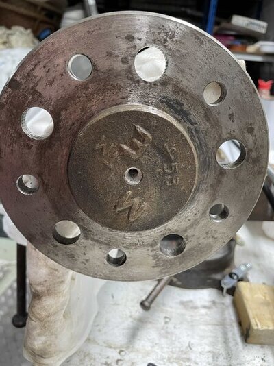

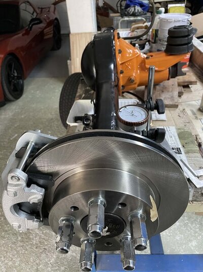

One of the nice things about the 8-3/4” is there are no C-clips. If you have ever seen someone spit out an axle because of the C-clips…
And I am a little biased:
