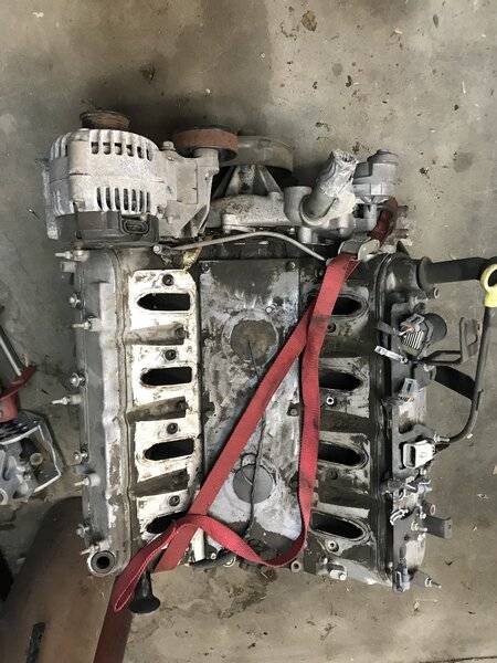

Well wish I had better news but I don't, still not running good, started pulling connectors on the coils and some made a difference where others didn't, need to check the injectors make sure they are spraying, I know the coils all tested fine. That and I need to pull the motor due to a bad oil leak, from the rear of the engine, so while that is out I'll put the injectors in a bucket and spray each one make sure none got clogged. The amount of fuel needed off idle was up high 90-100 setting and idle was 60-70, even tried lowering the size of the injectors on the computer with no difference, increased coil dwell time from 3.5 to 4.5 and no difference. So have stone more checks to do and find that dang oil leak.
Yeah tell me about one step forward and two back lol VS turbo said that they will clean and rebalance the injectors just toc cover that for $75 which isnt to bad.
No that’s a good deal. And I’ve dealt with VS a few times and he just did the twins for my boat. Great guy. BUT if it were my car I certainly would not spend another dime on parts until I knew the set up in the MS was dead on. It sure sounds to me like you have an issue in the software.
That's what the guy at the dyno shop is thinking too, maybe I'll just have them checked and check with diy to see if they can it the ecu out as well. Just to cover all bases.
Well just checked as far as software or version goes mines up to date with the 3.1.08. Now when looking at the programming that was set up before I haven't touched, on the trigger wheel, with having the 36-1 and a can sensor(from a Jeep) would that could as a dual toothed with missing one tooth, or would it be better to change it to one wheel with missing tooth? If its searching for a dual missing tooth type set up and ones not there could that cause cylinders to not function properly?? Just spit balling to greater minds.
