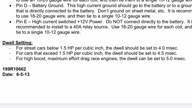

As for coil dwell, go with what the coil manufacturer recommends, not what MegaSquirt recommends. I used an aftermarket coil on our Jeep. Bench testing the coil, I got optimal spark at around 2.1 ms dwell (way less than your 3.5 ms). The Jeep ECU outputs a stock 2.8 ms. The additional dwell overheated the coil & fried it.
Here’s the Holley smart coil recommendation. I set up a dwell table and I’m at 3.5ms for driving and gets to 5.0 only when racing.
Thank you, yeah that's my current setting as well which from looking is also a good one for the Chevy type d585 coil, so don't think I burned them out just not the best quality ones I guess. I'll get the MSD ones ordered up here soon and just double check with them on their settings.
