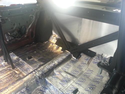

Hello everyone im the one who bought Mad dart's car been a slower process then his figure I'd do an update since I got the car few months ago. Havent done the motor or trans yet been working on the interior first. Put sone insulation on the floor, roof and inside the doors and quarter window area, installed and have mostn of it wired a EZwiring kit, adding power window to the doors bit thats it, have the motor and regulators just waiting till I get the front and rear glass reinstalled after I do the head liner. But front to rear lights are done waiting for the custom dash panel to be made, have the front suspension in the car just need to do the rear end.got some new wheels for the front since adding wilwoods front brakes the 14s wouldnt clear. Ill update more as I go, just did the carpet kit today letting it sit. Wheels are coys 15x6
