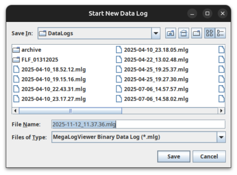

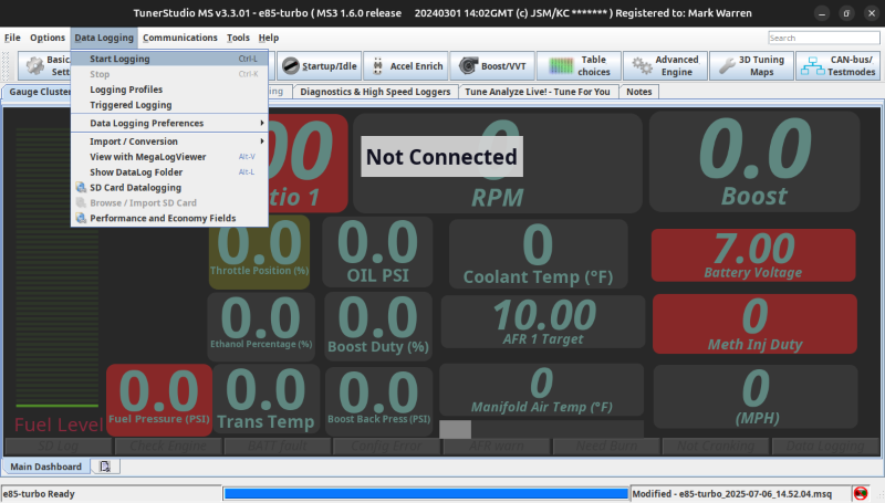

Try to get a data log and a composite log file. Connect your laptop to the MS3, then select "Data Logging" -> "Start Data Logging" and take note of where it will write the log on your laptop.
Got it, yeah I saved it to the desktop. Its hard to upload stuff like this to here
I looked and it looks like you accidentally uploaded a shortcut to the log instead of the log.
The MLG files from Data Logging are different - a high level look at all the sensors while the tooth and composite logs are close up looks at the cam and crank sensors.
Same problem. Could be an issue with how you're putting it on Onedrive. If the file ends in "shortcut.lnk" you have the wrong one
Unfortunately all I'm seeing in that log is one page and it looks fine. It's not the same log posted earlier.
This isn't showing any real errors either - the only loss of sync appears to be after the engine is stopped. I'd recommend trying to run both a data log and a composite log at once. They don't interfere with each other, and each will show things the other doesn't.
