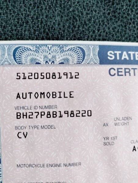

I'm thinking the title is not legit or the State of California don't know there *** from a hole in the ground and issues a title with the numbers found on the body. The stamped numbers are the Shipping Order Number found on the Fender Tag and Broadcast Sheet, they DO NOT MATCH THE VIN! Here is another example of SO#'s on a 1968. The VIN tag is missing as well as the fender tag because the "VIN" numbers on the title are wrong...
Yes title has wrong vin BH27P8B198220
That tells me this title was made up (2005?) after the dash VIN was missing and there was nothing in system for it nor person that took it to DMV had any past paperwork on it. Like no pink slip.

Yes title has wrong vin BS27P8B198220

BH not BS No 2nd gen Barracudas were BS.

The title that I have for the car is Vin
BH27P8B198220 not BS. I posted it earlier in the thread. Working with a friend of mine to get earlier history on the car so Will hopefully have more info soon
