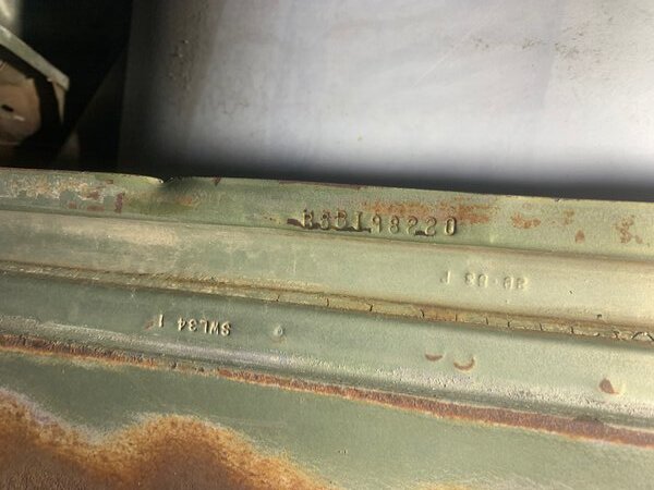

Maybe I'm too far into the rum, but didn't 68 get production sequence numbers stamped into the body panels as opposed to partial VIN'S?
1968 Formula's are different.....motors/trans and body #'s are stamped the same.....
Yes title has wrong vin BH27P8B198220
That tells me this title was made up (2005?) after the dash VIN was missing and there was nothing in system for it nor person that took it to DMV had any past paperwork on it. Like no pink slip.

Like I said elsewhere, those are Shipping Order numbers. Since there was no VIN on the dash, or fender tag available, someone decided that the numbers on the trunk lip were the VIN numbers and had the title reflect those numbers. I had to do a class for the Illinois Secretary of State about pre 1969 numbers on cars, they had NO IDEA until I proved it to them...

The trunk lip stamp shows a 340 Formula S because the motor code, year, and assembly plant. Because the lip paint is original and goes to the unique convertible parts this was a convertible. A lot of explaining. And once restored paint will be gone.
Dash VIN missing and THEN the title was obviously missing too. Then in 2005 someone tried to get is registered out of thin air. Either knowingly or unknowingly used the SO numbers for the VIN incorrectly.

Enlarging the photo of the stamping seems to indicate B8B198220 although the title shows a P8B

Agree - not sure why there's a B instead of a P - plant mistake ?
Why? Because someone was in a hurry trying to get a title based on a body stamping vs the actual VIN for the car. All Barracuda's start with a B ! Especially Formula S's... the Wife's build sheet for her '67.

Of course it's not. It also doesn't tell you it's a 340 car! The first letter for any Barracuda is B, not P ! 5th digit is the engine code..
