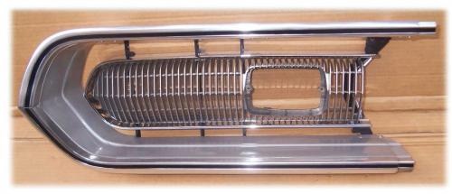

Wonderin' if someone out there knows of anyone who can correctly repair/replace mounting studs on 67-68 barracuda grille surrounds or has successfully done it yourself. this doesn't appear easy without doing some damage.
I repaired mine. They was in BAD shape. Rusted to the grill frame. I had to cut them off with a Dremel tool so the grill would come out. I've got some pics around here somewhere showing the hardware I used to fix and install back in the car. Give a little bit to find it. Pop rivets are your friend.

I have a friend that does this, and has made the special tooling to do them. He restores the whole sets of grilles, and did mine. The bolts he puts back into them are the correct ones.
The archived thread posted above includes the alternate fasteners I've used a couple of times also. Happy moparing

You guys have been given incorrect info. The studs on Cuda Surrounds are not rounded. They have a carriage bolt base, which is square. This prevents the stud from rotating, once installed.
There are MANY so called experts here on FABO and they all mean well, but they think that because they used a particular system, that everybody else should. This is not the case.
The photo shows the incorrect rivet also. The short rivets are used. If these rivets are used, you must trim the excess or your Surrounds, Headlight bezels will not install correctly. The excess rivet blocks the bolt from going on.
PartsMonsta makes custom bolts for all his resto Cuda Grilles and uses the shorter Rivets when the Grilles/Bezels are assembled.
You should just send him your core Grilles/Bezels and be done with it. This Guy saved me tons or frustration and time. The stuf turned out AWESOME.
old thread - and actually the correct rivets are semi-tubular 1/8x 7/32 and 9/32 and are squeezed and or pressed. From the pictures I've seen he does not do them this way. They appear to be "pop" rivets. I do use squeeze rivets though.
Correct on the stud though albeit a weak design, as I suppose they were never intended to be restored. But 5/8 and 3/4 t-bolt or molding bolts do work great w/modifications and give some adjustment over the weak press/peen carriage bolts.
