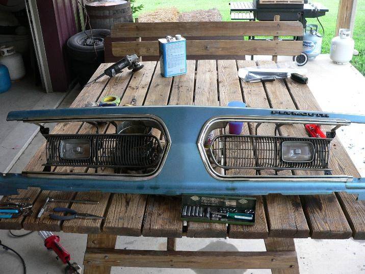

Got the Cuda stripped this weekend , about ready to get it to the body shop , except when I tried to take the grills out , about 1/2 of the studs just turn freely in the grill.....
I soaked then in penetrating oil , cleaned what threads I could reach with a cordless drill and wire brush. Even held one with small vice grips while I used a wrench. It would only slip in he vice grips.
I could buzz them off to get the grill out , but is there a way to replace them once the grill is out .
Any tips , tricks , or advise guy ?????
Thanks
Donnie

Drill out all the rivets, take the grilles apart , replace all the studs with 10-24 X 3/4 trim studs. I used stainless nuts on them too.
Pic taken from Mr. Gs Fasteners
What did you use to replace the rivets with ?
pop rivets
Reason I used stainless nuts on cadium plated studs is because if the threads did rust badly the steel head on that T stud could cut through the aluminum at next removal.

This is what I did with mine:
Here you can see the speed clip & maching screw w/ stainless washer & nut ( I thought it was brass... my bad)
I also ground down the screw head so it would fit under the trim, as you can see on the right.
I just tapped out the broken stud head using a hammer & punch and a small socket to support the bracket from behind. All the hardware I bought at Sears.
