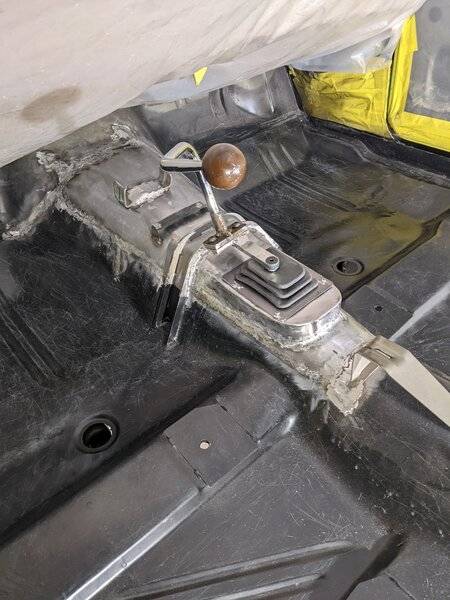

Tunnel is tall all the way back where that side to side hump is in the floor. A TKX is a lot smaller. Yeah may be able to modify bench seat frame to clear the bigger tunnel.

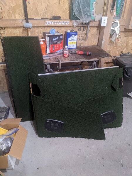

Removed rear panels for carpet replacement. I put some generic non matching green carpet back there in the '80s when I gutted interior to find and fix all the various water leaks.

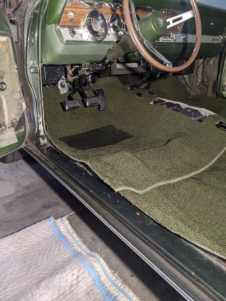

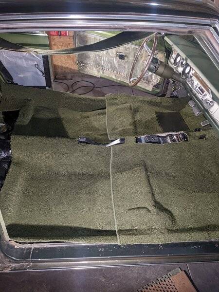

Was able to wedge carpet between floor heat duct and raised trans tunnel. Had to pull padding off back side of carpet in that area. It was tight took a while to wedge it into place. Normally there is 1.5 inches or more of clearance between floor heat ducts and original trans tunnel. Only the factory AC cars have those steel heat ducts close to trans tunnel.
Wrestled tugged pulled yanked pushed carpet around for hours trying to get a good fit. Which isn't easy on front half with the larger trans tunnel. Holes for seat belts, bolts/washers/nuts where seats will bolt down, rocker trim kick panels, high beam grommet etc. Still some lumps ect but fit is best I could get it. Once console and seats are in should look a lot better.

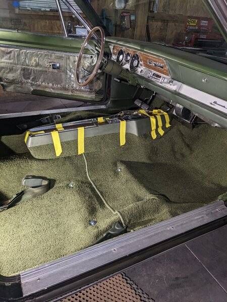

Glued the carpet to console. Used 3M two part adhesive I always have a tube of it around. Its thick like caulk, sets up in 10 minutes, and is crazy strong. Down side is carpet will never come off. But it worked really good was real easy could move carpet around for several minutes then it quickly setup.
Glue rock hard like fast so gave it an extra 30 minutes set console in car. Its sitting on those console brackets really good. The big trans tunnel is disguised. No one is gonna know a 6 spd is under there now ..

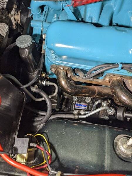

I had to add a cooler for PS system. Was losing assist when system heat soaked. After adding cooler i see 134 degrees out of box and 116 degrees into pump. Cooler sees 100 degrees in and 95 degrees out. 40 minute drive curvy country roads steering is working really good now. PS lines were 80 degrees before the drive.
