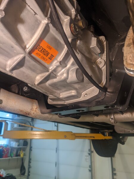

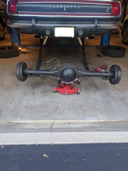

'69 Barracuda T56 swap, floor, cross member

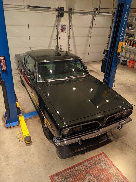

Had to use compound to get over spray off of paint. A lot of dirt grime came off paint too. Steel wool to get over spray off bumpers. Can't tell it went through floor replacement now.
Plan to drive it an hour away for large local show today. I think its all good mechanically.

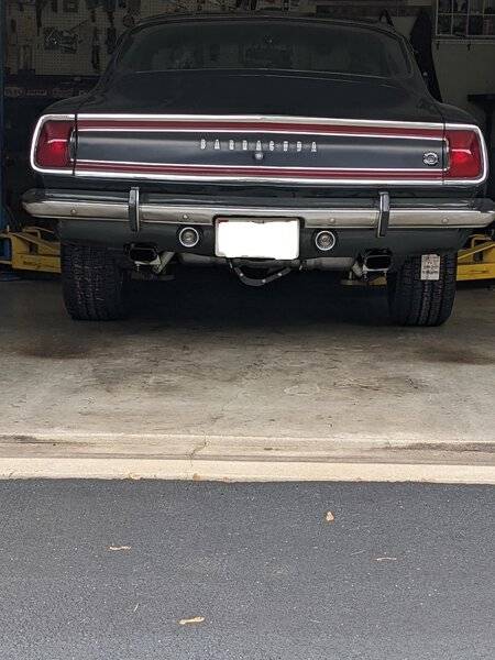

Put these out at car shows because a lot of ppl do not know what year car is etc...

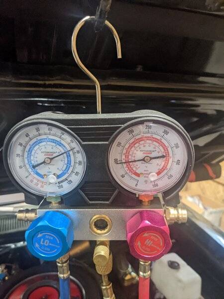

About an hour drive each way, several hundred cars at show, made the trip fine. Brake pedal feels more mushy then it should like brakes need more thorough bleeding. But otherwise car ran good. A lot of 5'th and 6'th gear driving at speed low RPMs engine stays nice and cool. Over drive gears so nice on the road trips. Barked tires when I shifted to second and third when I left show light throttle.

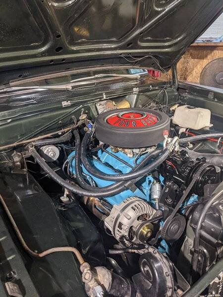

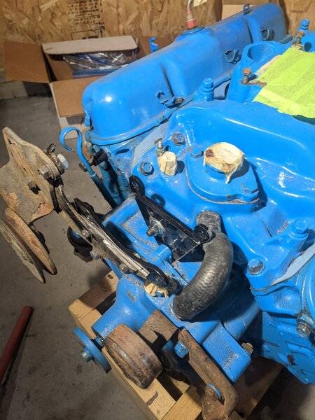

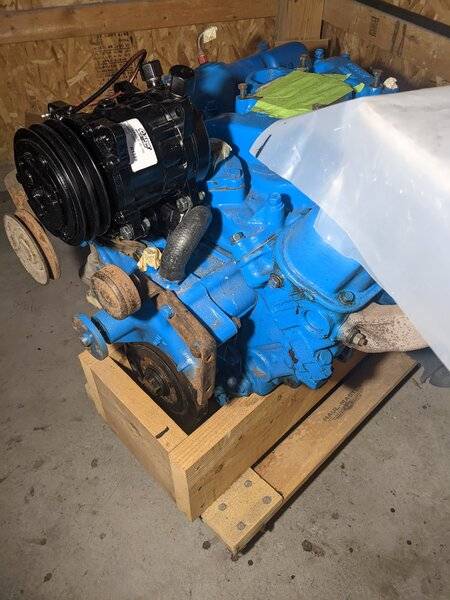

Modifying an extra '69 and earlier AC bracket to mount Sanden compressor. Goal is to use the front third grove in crank pulley as original AC belt did. Also use original AC idler pulley setup.
Rear support bracket is custom and mounts to a longer water pump to timing cover bolt.
Original numbers matching 340 is used for mock up so I don't have to lean over fender of car etc.
Installed on engine in car to check belt alignment. I still had the AC belt back when original compressor was on car in 1982 and it fits.

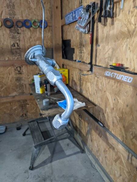

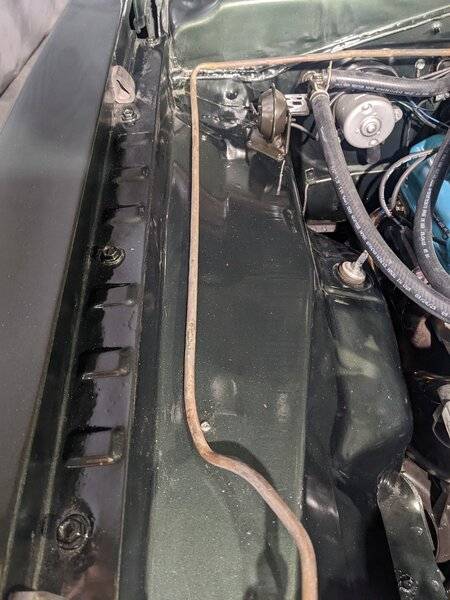

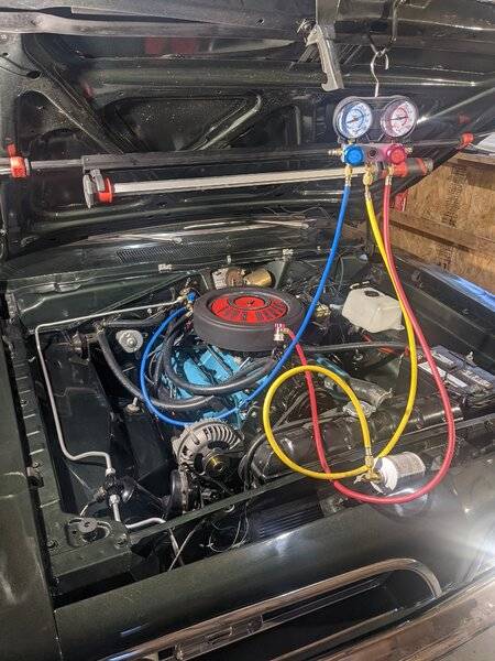

Custom condenser to filter drier hard line. Hard line from filter drier to firewall is original to the car.
Some guy on this forum used same condenser and custom hard line on a bronze '69 318 fastback. So I stole all the info from his build and copied it.

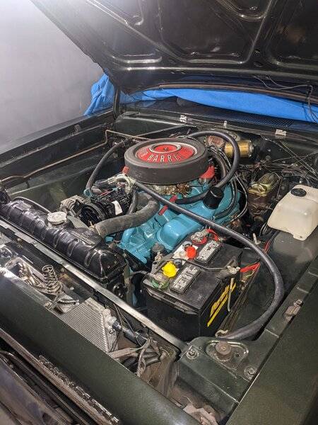

Mounted PS cooler on its own brackets down low so it gets a bunch of air on it as I drive. Pulled car outside washed it wiped down engine compartment.
