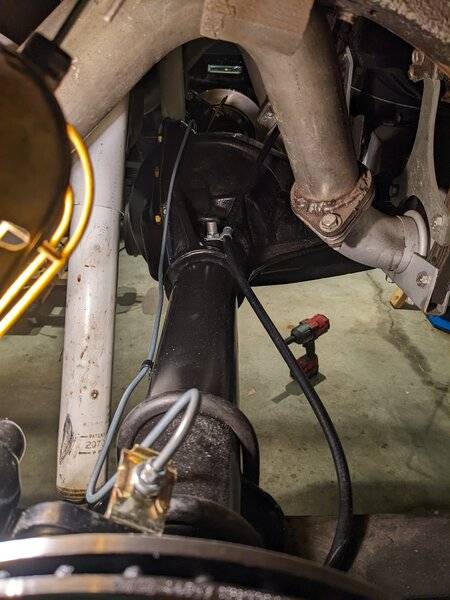

Eng/trans has 4 degree down angle. Pinion is 0 degrees level. Garage floor is sloped down front to back. In the other garage (which I believe floor is level) with 8 3/4 I remember something like 2.8 degrees down for both eng/trans and pinion. So with 8 3/4 both pointed down around same amount, but no vibrations? Anyway I think pinion angle has been improved with the Dana swap.
Had to swap on a '72 up A Body brake Tee to angle flex line more inward to clear the tail pipe flange. And rebend 3/16 hard lines accordingly. Typical unexpected car project type bull ****.
Clamped emergency brake cable to Dana axle vent since Dana missing tang/tab/clamp thing that was on 8 3/4 axle tube.

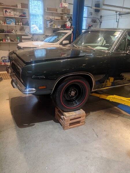

Doctor Diff big bolt pattern 11.75 rotors bearings packed with grease are installed. Working on Caster and Camber adjustment. AQ1 upper control arms which require using upper control arm bolt for Caster Camber adjustment. Garage floor is perfect level side to side. Looking to set 1/2 degree negative Camber and 3 degree positive Caster. Apparently I can get 6 plus degrees positive Caster so I am not limited there. Having to adjust with upper control arm cam bolts is difficult time consuming but with enough trial effort time I will be able to dial it in.....
Oh and prior to tear down I measured 1/2 degree positive Camber and 1 degree negative Caster both sides exactly the same. Car seemed to drive fine though? Would have been nice to know of those crappy specs earlier? Had car aligned decades back never knew how it was set up until now....
i assume you lift it up to make adjustments? when you lower it onto the blocks the suspension isn't settled so won't give a proper reading. you need to roll it back and forth a couple of times to do that. the only way to do it as you are is with 'grease' plates on top of the wood stands.
neil.
neil.
Yes you are spot on correct. I have greased plates for front tires to rest on and tire slides out a lot once I bounce suspension up and down. Also verifying ride height before measurements.
Slight toe in. Pipes with slits for string to sit in to get string square even to car.
Pass side had 1/2 neg camber and 2 degree positive caster. So made driver side match. Probably come back add more caster later but much better specs then what it had before taking it apart.

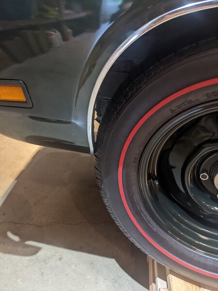

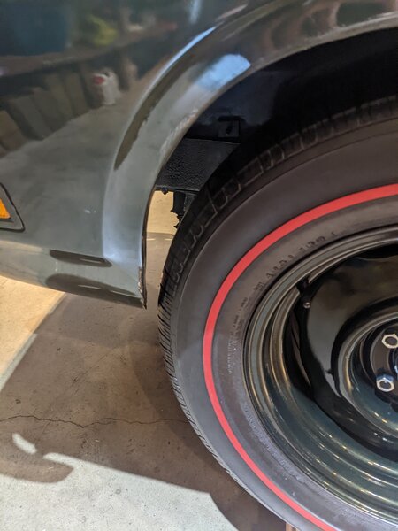

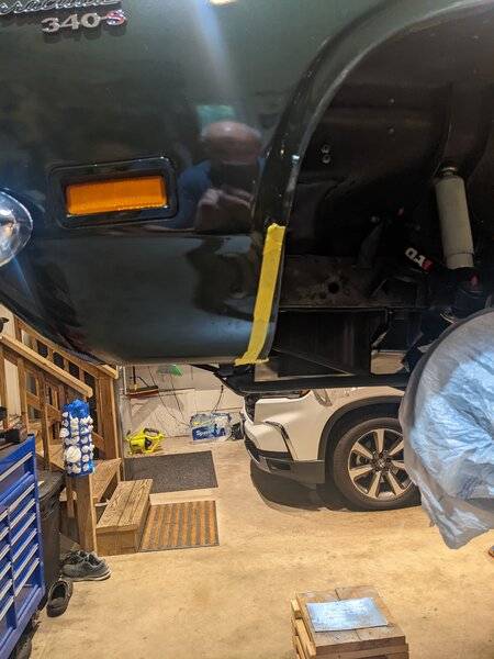

Typical second gen Barracuda tire clearance issue on forward lower edge of fender. 215-70R15 and wheel is 15x6 with 3.5 backspace. I wanted 27 inch tall tires front and back.
Used a dremel cut off wheel sliced a pie shaped piece out, bent forward, panel bond back side, touch up paint. Once wheel well molding on no one will ever know. Now a 1/2 inch plus tire to fender clearance.
