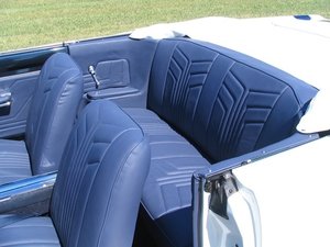

Rear interior panels are being reproduced, seen the top latches in Mopar Collector Guide
Mine has a cloth top with glass back window

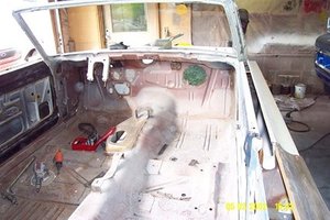

I had all but 2 bolts out of my car. The axle bump stops on the rear frame rail are the only think that was left on the shell when we built it.

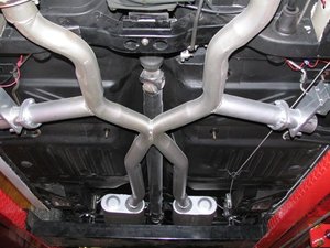

you can see the rear torque boxes in this picture
I have somewhere the build photo's, but don't think any from under showing torque boxes. If you know what Hemi B Body boxes look like these are about the same. I believe they are repo ing them also.
