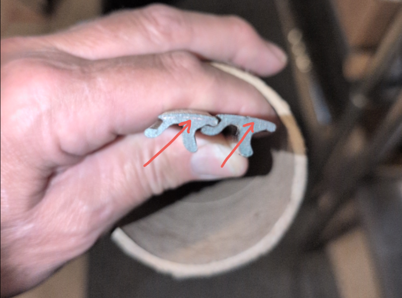

This is the lock strip that came with the seal
It is very heat and doesn't fit into the side trim well
This is a NOS (I have 2 and both look the same) sitting on top of the provided lock strip. It has a pronounced curve and a peak to it.
This one is a bit yellowed.
Provided
Note the change in shadow about 2/3 way up
You can barely see it but this is where the reflective part is ( red arrows)
