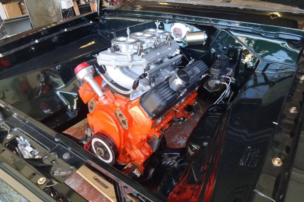

The intake gets cut, so no worries, the heads stay on. Thanks, but that was the engine in 2001, it has a different set of heads and a new intake now:

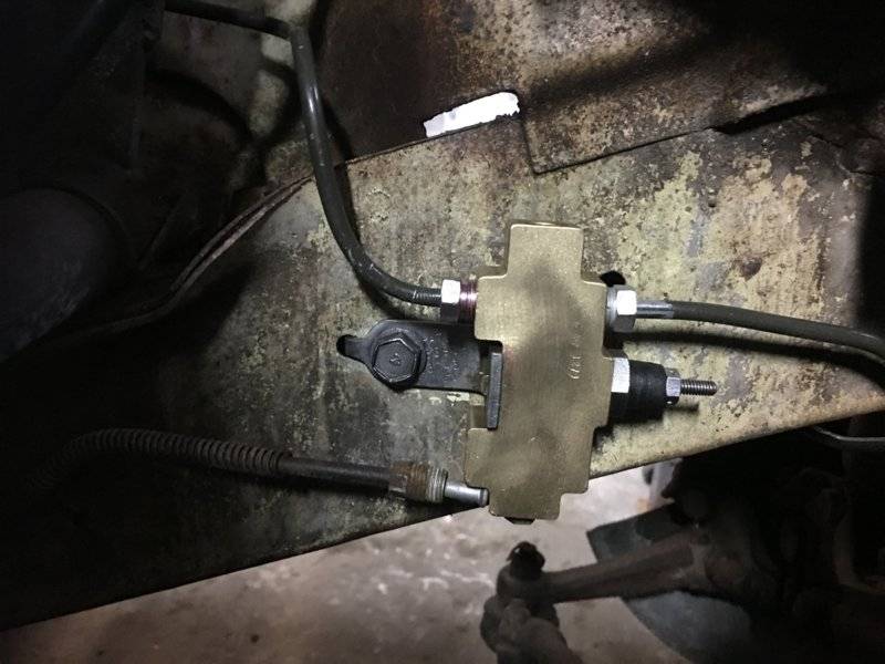

Are you considering bending replacement brake lines? Asking as I saw your question concerning the wire armor on the bends,, before you bend your own, check out replacement brake line sets from Inline tube,, I put their replacement brake lines on two vehicles,, they fit great. Inline also has the distribution block.

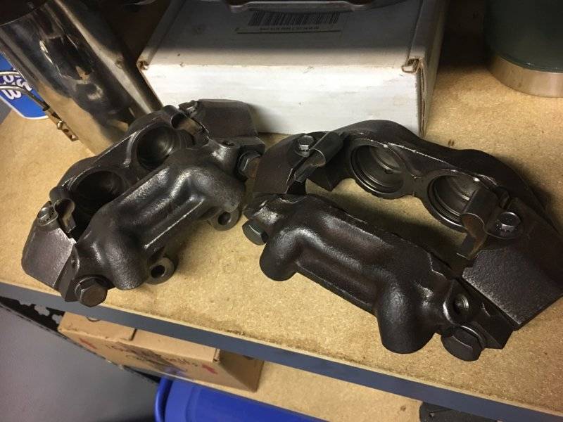

I had to use an air hammer to get he pistons out. The inner walls look very smooth, so I decided to stick with the originals for Now.

Started breaking down and inventorying the replacement parts for the brake system. I'll be running all new lines, fittings, master cylinder, new rubber lines, etc. what a beast of a job to unbolt the MC plunger from the brake lever. Very little room to fit wrenches up underneath the steering column!
Anybody know if the wire that wraps the tight bends is necessary?
The wire that wraps the brake line is called gravel guard. Like the name implys it protects the tubing from a kicked up rock from the tire that might damage or puncture the brake line. Some brakeline places sell the coiled wire ready to go to slide over your brake tubing if your bending and flairing your own. I believe inline tube sells the gravel guard by itself. Cheap too i think a 20' long roll of it is $25
