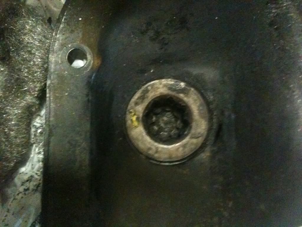

Decided to change the differential oil in my 66 Barracuda. After waiting three days (!) for the gasket to arrive, I am now faced with removing the drain plug so I can refill it.
The problem is that I've never seen a tool to fit this plug:
I can't find a replacement plug or cover. Advice welcome!!
Use a 3/8" ratchet or breaker bar- just be sure you get it seated all the way in before you lean on it.
Check your 7.25 rearend, if memory serves me right you need to use a 1/2" ratchet
Yes, you are correct: 1/2 is required. Thanks!
Unfortunately, it appears the previous owner installed it with an impact or pneumatic wrench. That sucker won't move.
You have a MIG? just weld a nice big nut to it

Hi! Is that yellow paint remains from a paint splot or has the cover been yellow before? Never seen that before. Where is your car assembled?

why not just go but the Torq driver that fits the plug
It appears to be a yellow paint dot. Pretty sure the cover wasn't all yellow.
My Barracuda was assembled in Los Angeles and has always been a California car.
I just acquired a new diff cover with a plug that was easily removed. In fact, a kindly FABO member sent me one.
